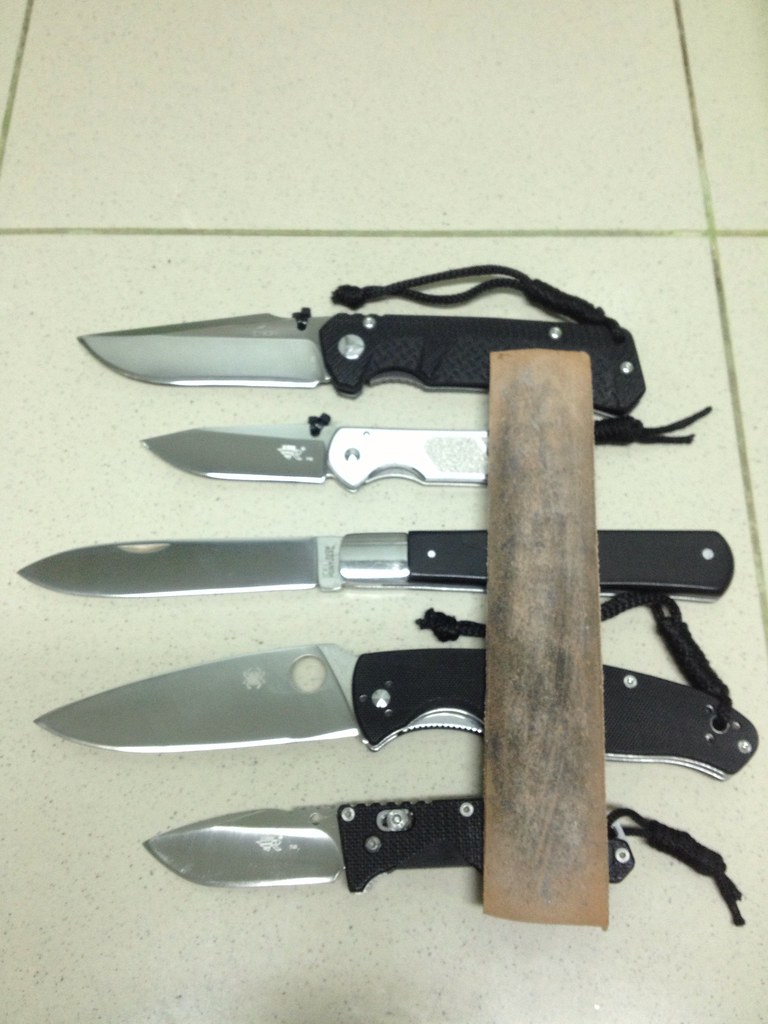

Tested the bulk compound sent to me (thank you Bluntcut!), I achieve new level of sharpness!
It's a testimony of my own skill (lack of thereof) and the foolproof concept of this 'balance strop'
Started with Sanrenmu 710, ended up doing all my EDC and it takes 5-10 mins each :)
Usually I tend to get my edges rounded when stropping. This compound (I only tested bulk one so far), brought the bite back!
Usually, the SRM 763 is my regular shaver. The 710 was recently resharpened to do the same, didn't quite get there but after this stropping session, it shaves even better and still cleanly slice newspaper at shallow angle! One of the best shaving session I have for a while!
Edit to add: tried to improve two Victorinix kitchen knives my wife uses. Waiting to hear the good news :D.

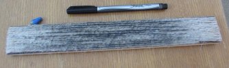

I've tested a strop surface made from small manila/jute ropes. After 2 weeks of test, I found this surface is more versatile and much lower maintenance than leather. Although, freshly charged compound on nap-leather produced a slightly more reflective/mirror finish. A well-used manila strop easily matched leather finishes.
+ A manila rope strop
+ Image capture setup
+ A Mora with new 26* bevel reprofiled and finished on on a brand new manila strop loaded with bulk white-compound (12-15um AlO)
It gave a clean dry shaved (low angle and not much pressure) of facial stubbles, also removed some skin in the form of dust. Sharp and too coarse :eek:
edit: should mention that this manila rope strop works quite well for stropping serrated knives.

USA Knife Maker - white compound under buffing category. Eastwood also sells this 3 lbs buffing-stainless for a slightly higher price <= I didn't test this, thus I would go with usa.
OSH or HD for manila/jute ropes. Optionally horse butt leather strips, Springfield Leather Company.
Any stiff board wood/plastic/paper will do.
