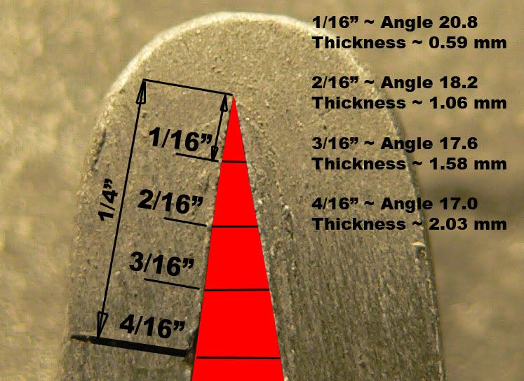

Here is my thread where I was checking the edge of my Bravo 1:
http://www.bladeforums.com/forums/showthread.php?t=775806
Here is a picture of the edge profile:
As you can see the edge is quite thin and angle is very low. How good or how bad that is depends on what you want from the knife and how you use it. My Bravo 1 glides through wood because of this thin edge and low angle, I did some batoning with it and it was fine, but I definitely try to avoid pushing it through big knots, if I don't have to. It takes 5 seconds picking up a different piece of wood, instead of pushing it, damaging the edge and spending 30 minutes fixing the damage. And this is 0.215 Bravo 1. I would imagine the edge on 0.156 Fiddleback can be even thinner.
Damaging such edge while batoning isn't very hard and also depends on type of wood, conditions and technique. But I must agree, that kind of damage during wood carving is a bit odd.
Some people like low angles some people don't.
I've read about a guy putting 20 degree edge on Busse. After some use edge looked like crap too.
I'm very interested to know if this issue with Fiddleback is due to edge geometry or heat treat. Edge geometry is easy enough to adjust to your own liking. It's much easier to go from 20 degree edge to 45, than the other way around. Heat treat on the other hand would be a manufacturing flaw.
I've seen this before as well, on my Ratweiler in SR101 steel. I had a convex edge put on it that was too thin.
The fact that it bent and didn't chip out is a sign of a good heat treat...
There's of course a difference between a factory convex edge, which is (should be) stronger than a flat/secondary bevel, and turning a secondary bevel into a convex which will definitely make the blade thinner and weaker.
What's interesting is that the steel seems to be both weak and brittle (both in the DT video and from reports of users). Rolling edges and brittle fractures, that's probably the worst way that a blade can behave.

I assume you are aware that the Bravo1 comes with a convex grind, not the V grind as shown in your picture :thumbup:
Kind regards
Mick
If you look at the angle measurements at 1/16" steps you will see that it is changing. That's the slight curve of convex grind.

Well, living in France, the hardest wood I can commonly have is seasonned oak. I tried my Clipper and the 2000 on it, and was very disappointed by the 2000, it got relatively important chips in the edge, but the Clipper holded better, though I had to sharpen it. Chipping and rolling, when it stays reasonnably small, is like an accelerated wear, and sharpening fixes the problem. It may take time, but it fixes. This kind of edge waving NothingCoherent show us is not at all the same kind of damage: it's not supposed to happen, and you have no way to fix it back to normal without insanely grinding it.
I really wonder what's the cause. Sure the edge is thin, but it's not a problem, as it's sold so, and many people used it without problem. Damn, A2 is supposed to be a tool steel, and should have high Young's modulus and yield strenght, it shouldn't deform just as if it was iron (I'm exagerating, but this edge is behaving like a sort of hard iron, not like hardened steel).
I think it's quite the opposite. It's much easier for them to grind off the damage on the edge at higher angle, making the edge thicker.
The damage is too far into the blade for that to work. I'd be losing a few solid millimeters of blade width if they ground it at a steeper angle. I think, anyway. I'm no knife maker! :p I just can't imagine it working considering how far back the bend is.
I'm not a knife maker either, but I'm pretty sure you'll loose a millimeter. That's the only fix that makes sense. If they grind it at lower angle, then the edge will be even weaker and instead of fixing it they are making the edge weaker not only at that spot, but along the whole blade.
If they grid it at higher angle, blade will loose 1 mil of blade width, but gain more robust edge.
You don't necessarily need to loose all the length of the damage. For example in the picture below, if 2/16" is badly damaged (blue color), they can grid more on one side and end up with green profile loosing only 1/16".
In your case, you might end up loosing even less than that.

I just spoke with Mike Stewart again, and he explained to me that they cut a piece of the edge off and regrind it thicker to fix this sort of problem. If he's unhappy with the finish, the knife will be replaced.
Definitely good customer service over at BRKT! But I'm still concerned about the actual strength of their blades. I know I'll be babying this knife once I get it back.
Edit: effer's above post appears to be exactly what they're going to do! Good stuff, man.
....Definitely good customer service over at BRKT! But I'm still concerned about the actual strength of their blades. I know I'll be babying this knife once I get it back.....
I don't know about babying it.
If the problem is simply an edge that was set too fine, then the regrind offered should fix the problem.
I would use it normally. That way you'll know whether or not it was a fine edge or poor heat treat.
Please let us know how the knife performs when you get it back :thumbup:
