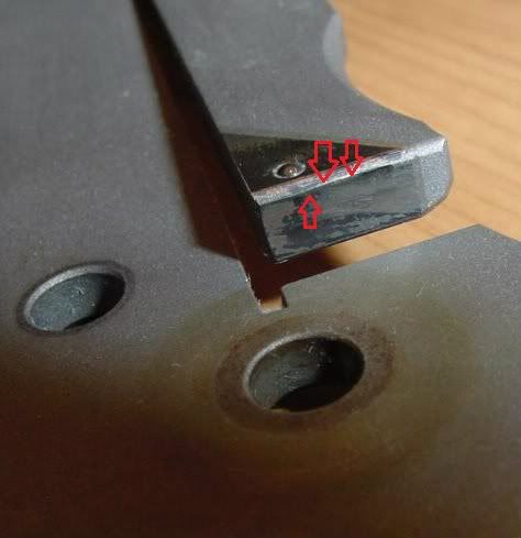

One of two user L-Sebenza's I own. I had it apart for cleaning so I snapped a couple pictures. I estimate this particular folder has been opened 55,000 times. The lockbar has no nicks in it and is flat. I don't "wrist-flick" to open but I do open hard with the thumbstud. Has a consistent 35% lockup with zero issues. Well done CR Knives.
I am personally convinced that the Sebenza is one hell-of-a-tough knife and that all the damaged locks are due to extreme abuse. Having said that I don't think the type of damage shown is caused by flicking the knife. Flicking open the knife should damage the stop sleeve and pin and not so much the lock-bar. I would expect the lock-bar to become damaged like that with massive spine-whacks and maybe batening the knife etc. So to me it seems that flicking is relatively harmless as seen on the video(especially if one doesn't wrist-flick) Still I don't flick my pocket knives because I'm way past 18 and I'm not a Ninja!!!

I must ask though...if the lockup is only at 35%....why is the wear on the lockbar all the way across the face?

Is it wear? "Flaking"? Looks pretty normal to me for a user. No pitting or uneven surface felt on it.
Looks more like years of use, cleaning scuffs, micro screw driver marks from moving lint and other debri's out from it and whatever else happens to the surface of a metal. Call it lock-bar liver spots. I've aquired a few of those myself after years of life.

That said, you quoted Tripton but never answered his question which is btw, a good question. How'd that 65% of wear show up? :confused:
The lock bar/face can always be pushed past the point it likes to sit at on the tang. That is why it looks like that, it's the same on my Umnumzaan too but you only see it on the blade obviously.

As for the wear...... I see no wear on my lockbar. Wouldn't wear show up as a surface no longer even? I see surface discoloration but felt no wear nor did I see any with a straight edge across it.

Looks like the oxide coating is worn across the whole face. No deformation though, so hell, I think it looks great.
I'd probably argue about the 35%....looks more like 50% on the vid. ;) Really though, who cares?? Looks like you have about another 400 years of use with that knife available to you.
Looks like the oxide coating is worn across the whole face. No deformation though...
Yeah, the oxide coating look like it's pretty well gone. I can't tell if it's the image or if there is a small amount of deformation along the base of the chamfer on the leading edge of the lock bar.
EDIT: Added arrows to pic for clarification

I agree 100%, there is pretty clear deformation in this pic.
His(LMT66) lock bar is fine, as he said. When you look at things with a macro lens it really makes things look much worse than they actually are. We see that often here on BF.
His(shOOter01) lock bar is fine, as he said. When you look at things with a macro lens it really makes things look much worse than they actually are. We see that often here on BF.
That's why I said it may just be the image. Either way, if he's fine with it and isn't experiencing problems (like rock lock), then it's a non issue.
