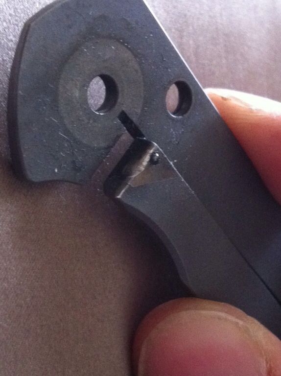

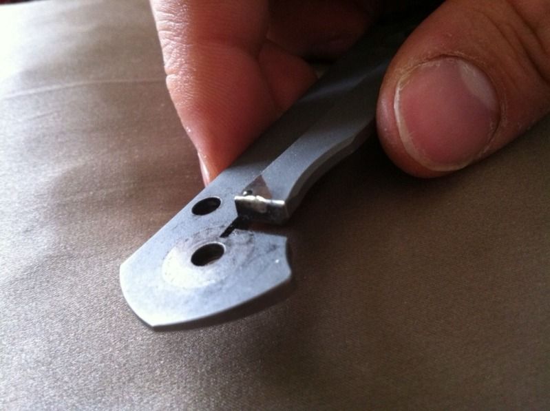

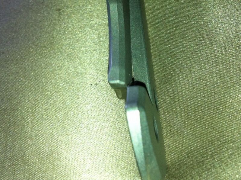

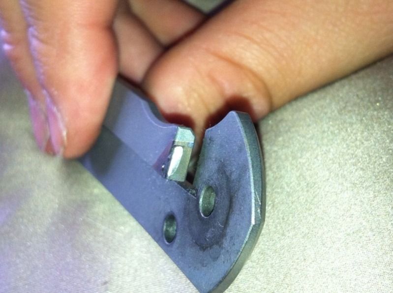

Here's what mine looks like:
The damage to my lock is reminiscent of the picture CRK posted. I'd love to hear they're analysis of why this is since it clearly isn't the hard flicking I was accused of. Given that the only downward pressure ever applied was on the jimping as one would during a hard cutting task, I have to conclude that again I either have a lemon or all of them can't withstand low to moderate pressure against the lock.
An alternate theory of mine is that this is the result of closing the blade slightly too early and the resulting pressure against the lock causes titanium to chip away over time. That said I clear the lockbar 99% of the time, which again means it isn't strong enough.

Here is mine from my sole CRK with the same problem; it's similar to yours
I was told it was either extreme flicking or 20k or more openings. In the thread about it (http://www.bladeforums.com/forums/showthread.php/790605-Is-it-normal-for-a-lockbar-to-dent-like-this), I wondered the same thing as you, if pressing the blade closed before the lock bar is fully out of the way could be the culprit. That was my first brand new CRK (second total), so with all the stories of lock bars being ruined through overextension, I had tried to press it over as little as possible, and sometimes that meant hitting the lock bar with the blade before it was fully out of the way. Looking at both of our lock bars, you can see the dent goes right to the detent ball. I don't understand how flicking would cause damage on the side like that. Whether opened very fast (flicking hard) or slow (standard opening), it seems like the same amount of force would be put on the side of the lock bar, just the spring tension from the lock bar trying to move over. On the other hand, not having the lock bar out of the way before the blade is pressed in would cause damage all the way from the detent ball to the lock face. It definitely seems like a possible reason for it.
off topic: earlier I said Mr. Reeve said the sole cause of my problem could be 20k openings. Rereading that thread of mine, he clearly said extreme flicking could also be the culprit. I guess I should've reread it since it's been ~1.5 years, and clearly I forgot the whole conversation. I guess I kept in mind the 20k openings as the only possible culprit given since it wasn't flicked like that. Anyway, sorry for the confusion.
All in all I have seen multiple people come to light about these issues and there is obviously something wrong.
