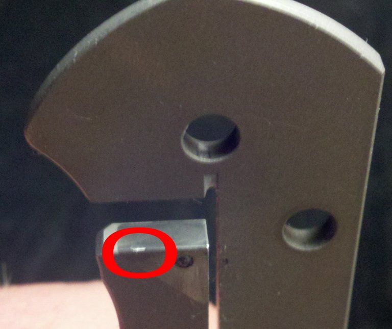

I have one sitting here. Lock face has noticeable deformation, and this is a "new" knife from the knife store. It's here for modification.
I ran out of memory on my phone but hopefully you get the idea. The "gouges" on both my are very small, but there is definitely deformation there. Doesn't affect lockup in my case though. The marks on the lockface are exactly where the blade tang comes into contact with the lockbar when the lockbar is not moved all the way out of the way.

I get what you are saying. I would say that in general a Ti/hardened steel friction joint is a bad idea, and it is very tricky to get it right, hence the steel inserts. It seems as though Spyderco either figured out how to properly work Ti, or they figured out a way to geometrically make the joint work because they no longer do that on any knives that I am aware of. Having said that I think the question above me is a good one. It does seem like a new issue which points again to a defect in the Ti, and not CRK's geometry. They have a proven design unless they have changed the geometry of the knives.

I have quite a few different Ti RIL knives here...Benchmades and Benchmade collaborations, Spydercos, Striders, and probably a few others I'm forgetting. Some, like a 30 Skirmish, seem to have 100% surface engagement and a relatively flat (in one dimension) tang surface. Others, like the Stiders (and the Military) have a deeply concave tang surface and at least in the case of the Striders a very small percentage of surface contact. There's gotta be things going on with these differences. BTW/FWIW, Strider just changed their tangs so the radius of the concave grind on the tang is much, much larger (so the tang appears almost flat). I think they will probably have a longer service interval with those...but this stuff is not my field, just a hobby. And I'm probably way off the thread by now anyway... :(

I was just referring to the wear potentially coming from not pushing the lock-bar all the way over and the blade tang scraping by on the lock-bar upon closing. If the blade tang has a sharp edge and has not been beveled, it could be the cause of the gouging that we keep seeing. Ti does not obtain very high numbers on the Rockwell C scale, so it will wear of course but would also be susceptible to a gouging I would think. Seems like the best answer so far.

I seem to have the beginnings of the same marks on one of my Sebenzas. I've only been carrying it a couple weeks though and like yours I've had no blade play nor locking issues so I haven't paid much attention to it nor have I been concerned. It was purchased new from a dealer. DOB March 22, 2012.
Not the best pic, but could get no closer:
Lock up is solid. Zero wiggle on the blade. Used with confidence:thumbup:
Therefore, closing the knife 1000s of times without completely displacing the lock-bar before closing the blade (i.e. rubbing the blade tang alongside the titanium lock-face to detent ball) is akin to 1000s of extremely soft spine-whacks. The force (linear motion + torque) applied to these areas over time is analogous to the power of dripping water slowly eroding through stone.
