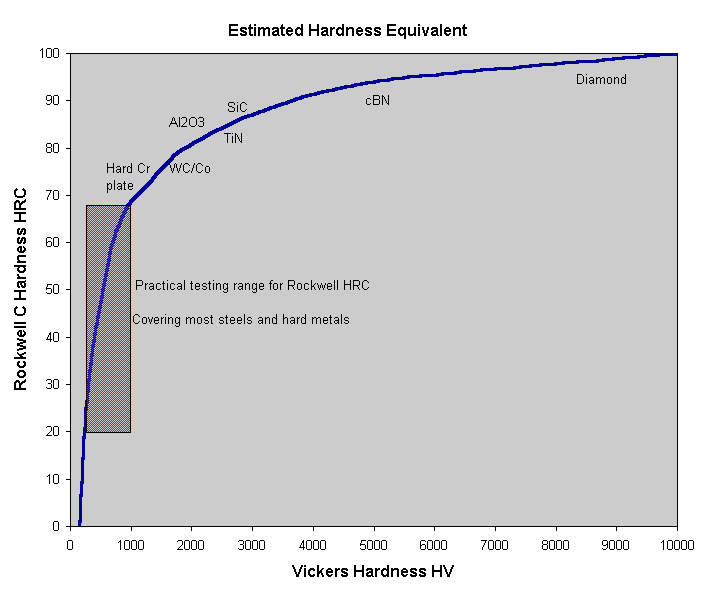

P.P.S. I think the hardness of zirconia is around 70 on the HRC scale. I looked up the hardness of zirconia, which is often given on a different hardness scale (such as Knoop Hardness, or Rockwell A Hardness, etc.), and then can be (approximately) converted to Rockwell C Hardness.
http://www.tedpella.com/company_html/hardness.htm
http://www.grantadesign.com/images/hardness.fe2.gif
http://www.gordonengland.co.uk/hardness/hardness_conversion_1c.htm
The Vickers Hardness scale has one of the widest applicable ranges. Under the Vickers scale, zirconia is pretty darn hard. But it's not as hard as many things. So it is not accurate when advertisers say that Kyocera's zirconia ceramic knives are second in hardness only to diamond. Even aluminum-oxide is harder than zirconia. Aluminum oxide, as hard as it is, is only about 1/4th the Vickers hardess if diamond, and even cubic-boron-nitride is about half the Vicker's hardness of diamond. More or less, it is accurate to say cubic-boron-nitride (CBN) is second in hardness only to diamond. May not be litterally true, given other materials (I forget how hard borazon is) and maybe research materials like nano-carbon-tubes, etc. But probably true enough to say so in an industry presentation.
Also if you are curious, diamond does not have a single hardness, because it is harder along some crystal axes than others. But it's reasonable to give an average of these hardnesses.
I really like this plot from http://www.gordonengland.co.uk. It shows the hardness of many common very hard materials. It also illustrates that Rockwell C Hardness is not linear in Vickers hardness. Although it is not obvious from the plot, but an infinitely hard material would have a Rockwell C Hardness of 100. This is a peculiarity of the Rockwell Hardness Scale, which you can read about on the www.gordonengland.co.uk website.
http://www.gordonengland.co.uk/hardness/ehe.htm
http://www.gordonengland.co.uk/hardness/rockwell.htm

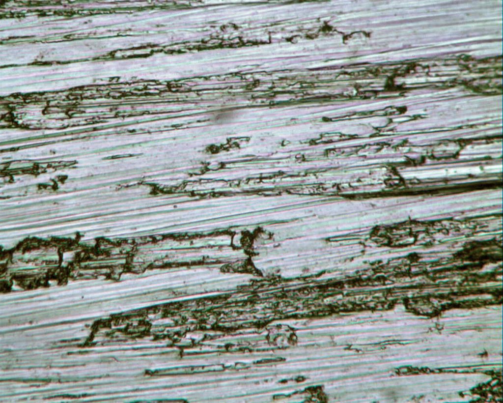

Here is a photomicrograph of the Sharpmaker ultra-fine (comes with the medium and fine rods so I ordered a set of the ultra-fine too)
[Broken image link: http://members.cox.net/pihughes/superf25.jpg]
(25x objective, about 1,400x total). There are some larger and quite a few smaller (plus the tips of larger grains poking out of the matrix), but the majority of the larger grains appear to be around 2,000 grit JIS. But they are rounded and held tightly in a very dense matrix so they do not cut at all like a waterstone. Instead, they burnish like an orange stick on modelling clay, and, also like smoothing clay with a stick, the rods seem pull loose little balls of metal and smear them over the surface and leaves a finish that looks like this:
[Broken image link: http://members.cox.net/pihughes/surspyuf.jpg]
Leaves the burnished part nice and bright the surface isn't exactly smooth. Here is the same hunk of metal that I polished on a Naniwa 10k at a right angle to the sharpmaker that exposes the gouges made by the balls of metal the sharpmaker pulled up:
[Broken image link: http://members.cox.net/pihughes/surnansc.jpg]
Anyway, while the UF rods are probably 2k-3k grit abrasive, they do seem to leave a 5k-8k finish in the smooth burnished parts (the gouging/streaking makes them unsuitable for polishing the sides of blades but that should be less of a problem on a thin edge bevel).

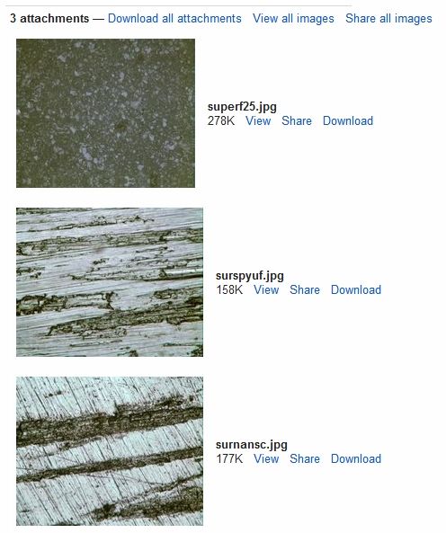

E-mail from yuzuha to Lagrangian with recovered photos:
From: yuzuha
To: Lagrangian
Date: 2012/05/23
Subject: spyderco stone pics
Hi got your e-mail. I left a note on bladeforums (OMG I actually remembered my password for 6 years! Now if I could just remember why I went into the other room!) My ISP trashed my web space including my web site, and the pics I was hosting on it, but I did find some of the pictures on my old PC.
Superf25 is the spyderco super/ultra fine rod at, I’m guessing about 1,400x
Surspyuf is the .25" x 1.5" surface of a .25 x .5 x 1.5 inch block of stainless steel that I polished on the rod
Surnansc is the same surface polished on a 10k Naniawa super stone (not the chosera) at a right angle to the spiderco to show the gouges left when the steel galled under the spiderco.
A knife bevel is smaller and the steel is a trifle harder, and carbon steel is not as gummy so I doubt you’d see tear-outs like that unless you were actually trying to polish the side of the knife rather than just sharpening it. Even then it is microscopic. The side of the block was a hazy mirror finish after the spiderco and a bright mirror finish after the naniwa but the gouges were not noticeable to the naked eye.
Glad to see there are even more crazy people in the world that think about this stuff J
Now I am going to have to read all those links in that thread you guys created. Anyway… hope the pics help.
Later,
Pam
[ Images attached to this e-mail are now at imgur.com in the album:
https://imgur.com/a/KVdMk#0 ]
