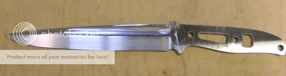

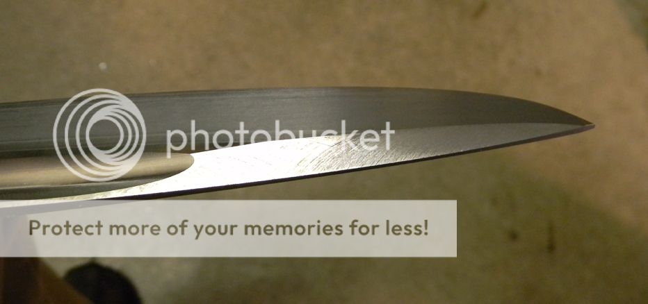

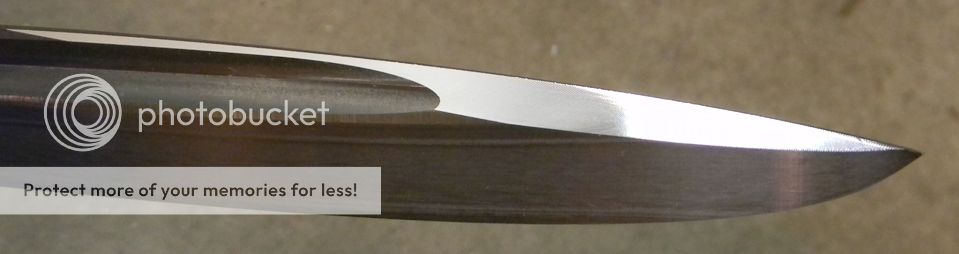

Okay, to continue where I left off. I'm on the home stretch here on the blade (the scales are next) but I'm having problems with the surface finish on the swedge grind. Rather than just show you the solution I thought it might be educational to show you my attempts at fixing this before I got it right. This might not be the most interesting part of the WIP, but anyone who has struggled with surface finish will be able to relate.

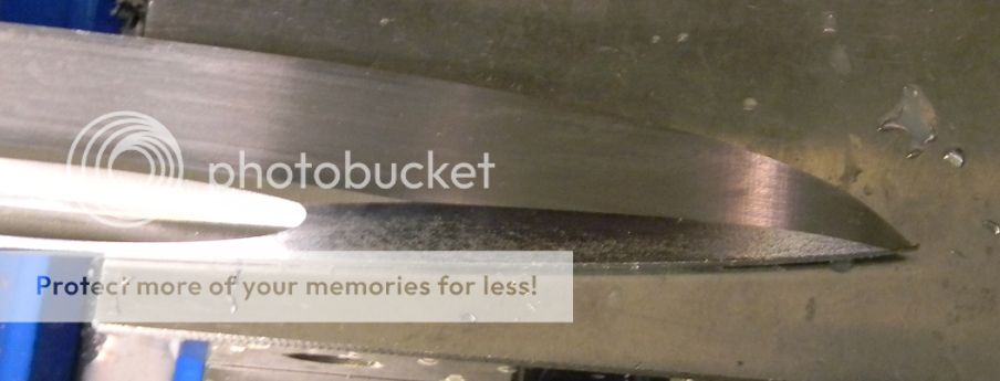

I'm trying to achieve a fine finish on a small area on the back of the blade. Should be easy. I'm using the same insert and the same speeds and feed that I used before that worked so well. The problem is some wonkyness where the insert enters and exits the cut (there is always going to be a little bit of this if you look closely enough) and some righteous chatter when I flip it to do side two due to the reduced support. The SFM I'd been using was really high. High SFM is an easy way to get a fine surface finish when using carbide and it allows me to make the cut in less time. The obvious first thing to try was reducing speeds and feeds. I'd been spinning it at 1900 RPM, I dropped it down to 1000, then 500, 250 and lastly 100 RPM. At 100 RPM the chatter was completely gone, but the corresponding feed rate was so slow (1 IPM) I think I actually started to get into some stick-slip on the machine feed that showed up as regularly spaced crisscross marks in the surface finish. Regardless, at those slow spindle speeds the BUE (built up edge) was awful.
500 RPM:
250 RPM
100 RPM

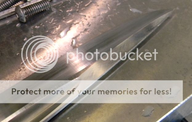

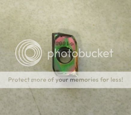

Okay, that isn't going to work. I know, lets try something a little unorthodox. Lets use a super sharp Diamond-Like-Carbon coated insert designed for fine finishing of aluminum. These inserts are sharp enough to cut you and cost over $20 a pop:
Oh wow that turned out really bad
(that is some gnarly BUE, apparently steel likes to stick to carbon, who knew...)
I tried an insert designed for brass with similar results. Being uncoated carbide run at low speeds the chip likes to stick to the cutting edge, resulting in BUE. That BUE results in a nasty finish because the actual cutting edge is a glob of steel stuck to the insert.
Okay, so everything I'm doing here is going in the wrong direction. I'm being lazy and trying to fix a problem with cheap tricks rather than do the work and address the root cause of the problem which is that my fixture is not supporting the part well enough to prevent vibration. So, getting back to machining basics I go back to the original insert (which actually is the right insert for the application) and set it at an SFM that is high enough to prevent BUE and focus on eliminating vibration.

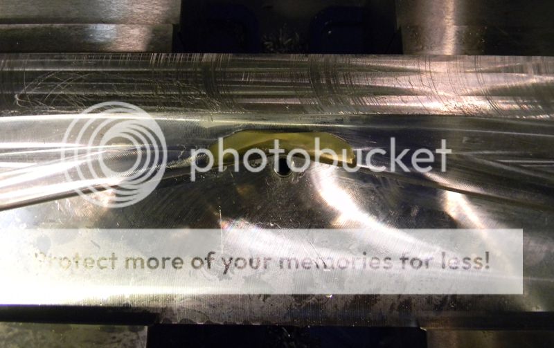

There are generally three ways of reducing chatter. 1: Reduce SFM (not an option, any lower and I get BUE) 2: increase feed rate (not an option, gives a poor surface finish and not effective in this application anyways) and 3: improve the setup, generally by improving rigidity.

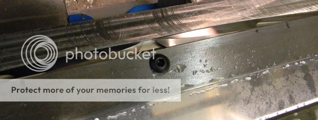

I've been avoid that last one because it means I need to do more work on my fixture. However there is one last simple trick I haven't tried yet with is a glop of bubble gum or modeling clay stuck to the part to increase its mass, change its natural frequency and damp vibration. Okay, I'm not literally going to glob bubble gum onto my part but I'll do the next best thing. This is a piece as soft-as-chewed-up-gum rubber glued into the fixture:
That is 20 durometer shore A polyurethane thermoset elastomer. Nice and soft and squishy and good at absorbing vibrations. This actually worked. I shaped it to conform to the primary grind because I don't want it to hold the blade up off the fixture. I still want the blade to sit fully hard against the fixture, but I want this rubber to press against the part with about the same amount of force as finger poking against it. Machinists have long known that sometimes all you have to do to quiet down chatter is poke your finger on the part. Using my actual finger was not an option, but that glob of shaped rubber is doing the same thing.

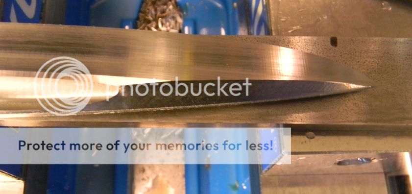

The first cut looks promising:
And side 2, which had been squealing like a stuck pig:
That's gonna work. It's about time...
So, this was the last machining operation on these blades. They're ready for heat treat.
