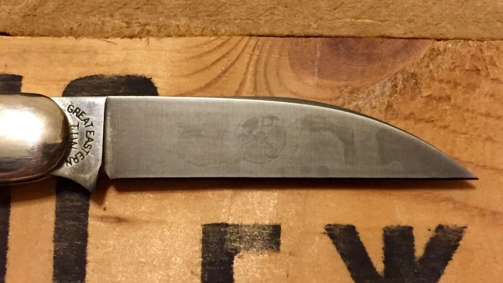

I found the corners too sharp when in the closed position. There were two small sharp "horns" from the manufacturing process. I checked closely to make sure these protrusions were not contacting the spring in the open position before doing anything. I use emery cloth to break the edges to soften the edges. I did not do anything drastic. I placed the edge of emery cloth on the edge of a wood bench and lightly touched up the corner when in the closed position; not on the presentation sides. Started with 600 grit and ended with 1500 grit to polish it. (I actually tried 150 grit first but it was too rough for this delicate of a job.)
Edit: This is still a little sharp but a lot better and I am happy with it. I could safely take off more material if i wanted but am going to try this for a while.
BTW - this is my new Coyote! Love it! I carried it at work today - so this will not be a collector item for me. (Sometimes I have a hard time carrying a new knife.)
