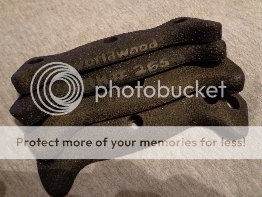

I absolutely love my 15 for just about any cutting task. I cant even go back to my mora or any other blade not because of it. The only thing that has been competing in the thinner longer (+4") crafting blade range is the old frontier forge knife I reshaped the handle on but the 15 holds an edge better. Anyways, the ergos on the tweeners are amazing, but there has been only one small grief, the "neck" of the handle is a little too slim so when I really really put out on the blade it bears down on the web of my thumb and pointer causing some discomfort. SO... I made some liners to help alleviate this problem. Went out and tested and yes the web discomfort problem is gone but the handles are definitely thicker. Will have to test for a while longer to see if I actually like it. So far so good. Also did some testing with the stippled handles this weekend awesome grip!, but not for comfort.... Put a coat of paint on them to make them a bit less grippy, but these would be absolutely perfect for slick, bloody tasks like dressing a deer. Now I just need some micarta to try out, I think micarta with liners would be killer.

Those stippled scales are the "peanut butter" ones lol! I have done some media blasting before and you are right it definitely adds that bit of grip. I ended up just sanding the scales on my 2 and it had basically the same effect for me. I like the slickness of the full size Beckers. In my opinion the handles on them really cannot get any better, but the 15 is just that little bit too slim in one place... handling the knife with the liners I think the "heel" of the handles might be a little too thick, but I would rather have that than too thin up top.

Yah they started out as stock tan scales then they were this....
Then this...
Then they were stripped back to tan using paint stripper... FYI paint stripper will slowly leach out rit dye...
Then I stippled them...
Now they are stippled, painted, and lightly sanded to bring out a little of the tan.... suckers have been through a lot!
DANG I should have done something unique like that to mine! Very cool WW and BSmith.
On a side note I was actually fairly surprised how easy it was to stipple... I used a wood burner with what would be I guess a calligraphy tip or something. It didnt take as long as I thought it would either. Again, this would be the perfect mod for a knife that is going to get covered in blood and slick fat. However, I still have the horse stall mat mod in the works ;)
