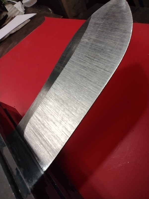

I'm thinking/hoping it's just the thicker stock, for whatever reasons, I'm not seeing the flaking on the thin stock. This is my second thin edge I'm working on. No issues.

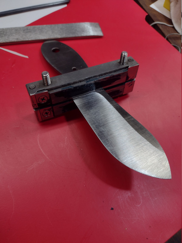

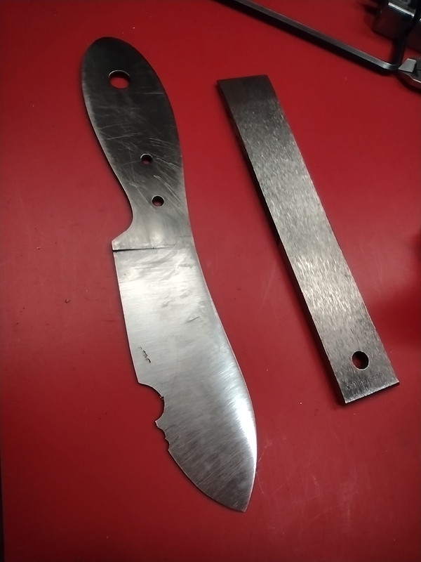

. I battoned maybe 6 times with the logs length ways...... It was Cross battoning that broke it
Whats the grain structure in the breaks looking like?

I sent the previous broken one to Joey, I don't have it... I could grind/break more, but I'd rather grind some good blades for a bit

This was the blank that I was first having problems with. I started grinding the false edge, and was getting flaking. I was able to grind past the flaking on the false edge, but stopped when it just kept reappearing.
The false edge is shown in the middle of the bar.
