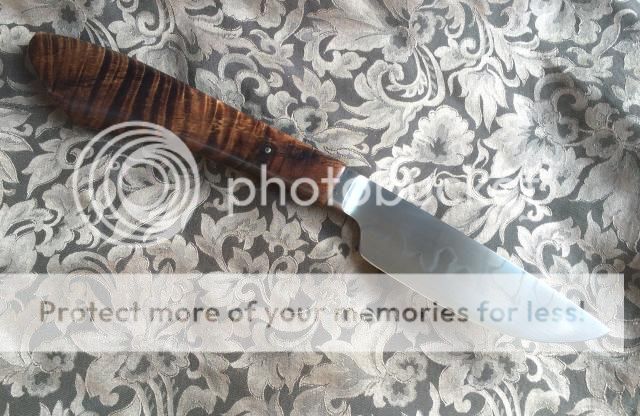

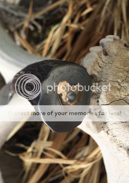

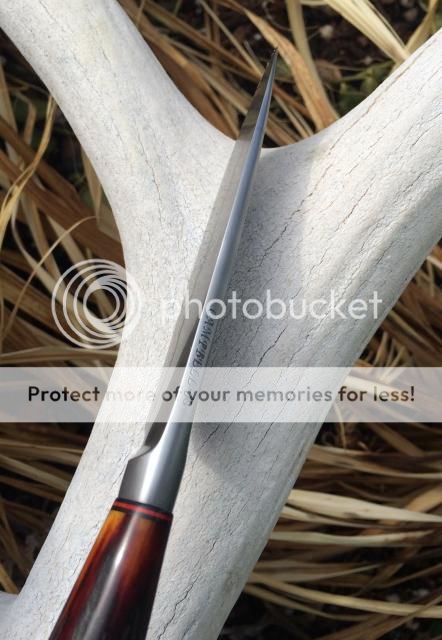

Finished a couple of Integral hunters yesterday, just gotta build sheaths and they are ready for the trip to AR.
4" W2 and a nice piece of Koa...

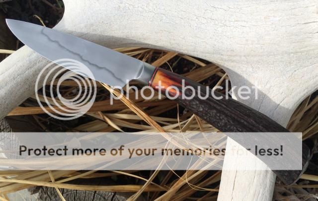

Next is a 3 1/2" 1095 blade that gave up a decent Hamon, a Stag handle and Wrought/Bronze butt cap...

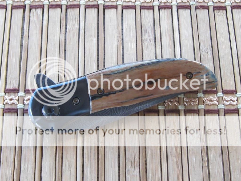

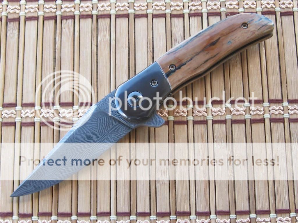

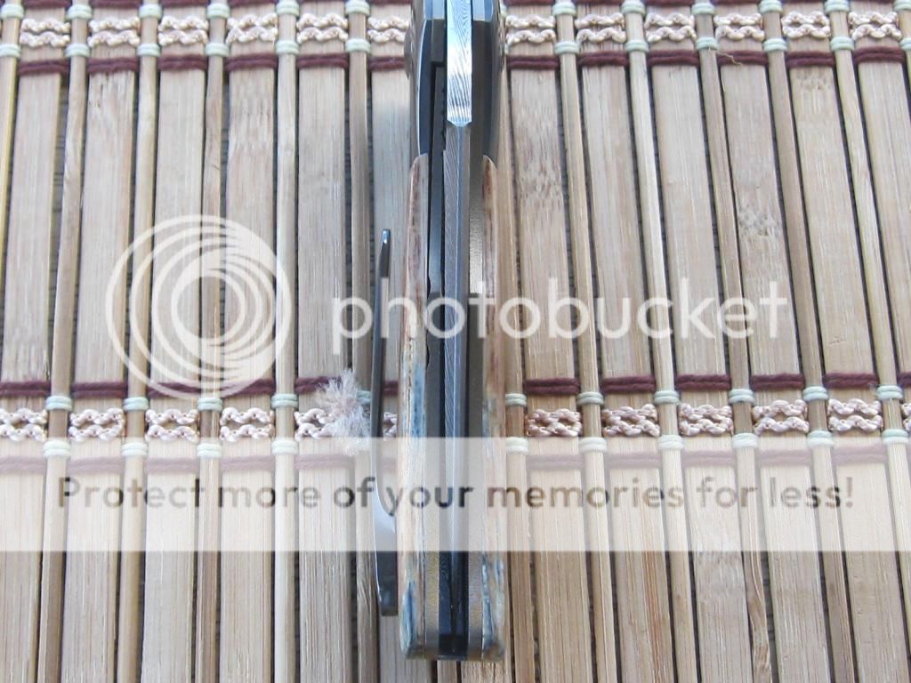

One more of mine making the trip. Damascus / Mammoth / Zirc bolsters and pocket clip.

The stag knife is wonderful.

Doug, very nice integrals. I am looking forward to seeing them.
Bing, that's another beauty. Looks like you'll have a great table.

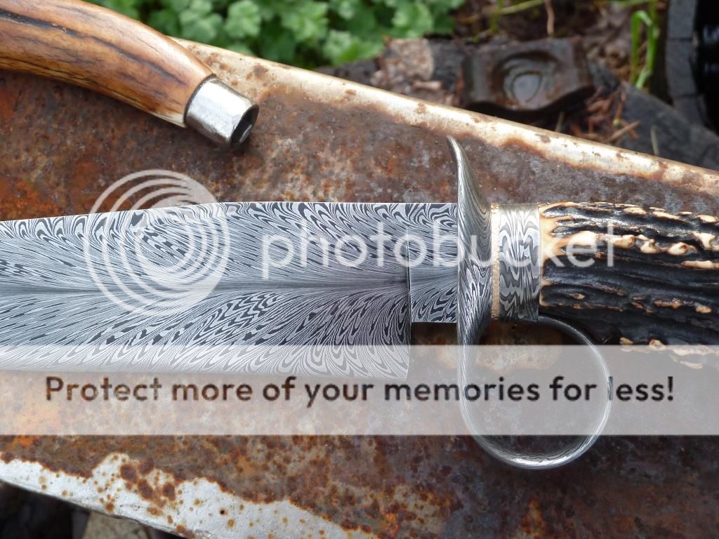

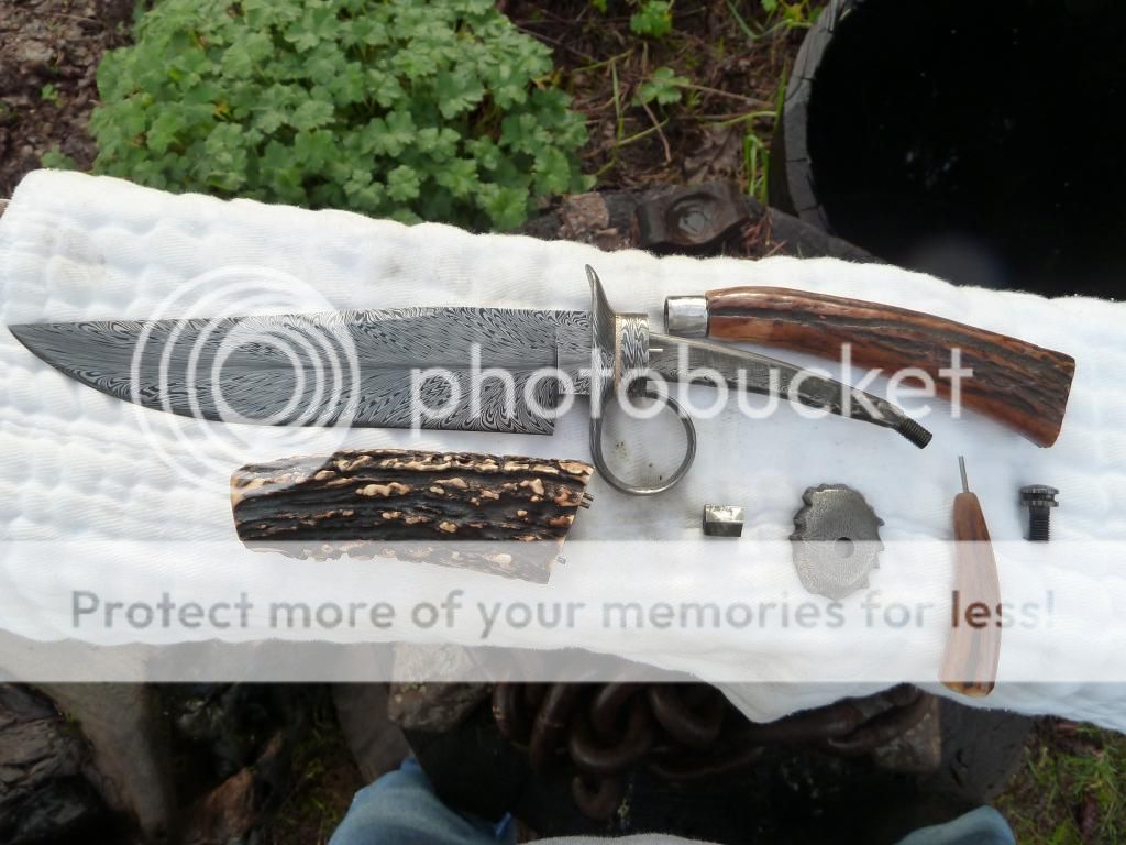

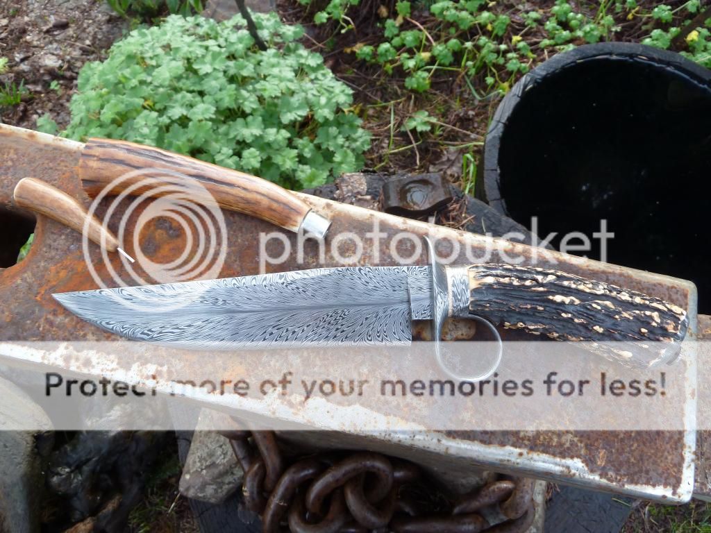

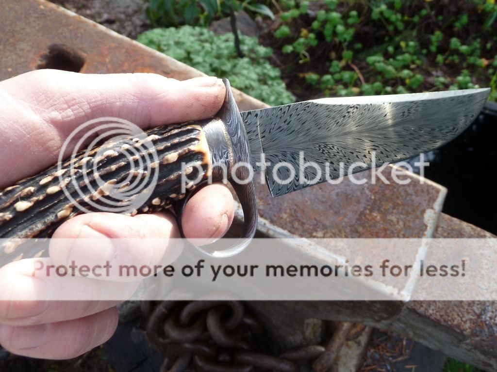

Man things are shaping up nicely going to be another great show I will be bringing 5 I hope and I would like to show one hare on this thread this is something new I am playing with and I am happy with how it's going. This is a stag takedown it has a steel plate fixed on a shelf I carved into the butt cap I then use a barrel nut to lock it up solid not using all the thread's of the barrel nut I am able to use a damascus finial I made and some index pins to lock on the butt cap. see you all in little rock safe travels.
Dave, this one has my interest. I like the straight Bowie blade and the ring in the collar is something I have not seen before. Gary
Thanks Folks Chris the blade is 7-1/2 OAL is 12-1/2 the spacer is stipple bronze Gary I am glad you like it the ring feels really good being flush with the spacer like that
That's a pretty one Dave!

Dave,
Love the way that you mated the ring guard with the stag. You're quickly becoming "The Man" when it comes to a ring guard. You're an inspiration.
