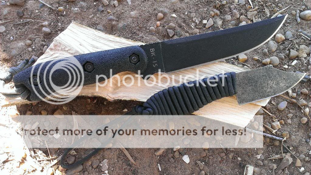

As promised here are some pics of the Plasti-dip scales I did on my 15. Really digging it so far. Also included in the ugly saw blade knife I made. I plasti-dipped the paracord wrap and it is a much better handle now. The thing is so thin. As I said before... dont know how but it turned out to be a really good cutter for being fugly as sin.
Ok enough with the pictures. None the less the product seems to be pretty well suited for this application so far.
Is that the plasti-dip's natural texture, or did you do something to it? The 15 scales look great.
The only reason your little sawblade knife is ugly is that a concave clip on a blade that deep and short just looks weird. Turn it into a straight clip or dropped spine and I bet it will look better.

The 15's scales were stippled and sanded prior to adding the rubber spray. Thats why the texture is the way it is. And that saw blade knife ended up having that point because of 1 part learning experience and 1 part drunken grinding. It originally looked like a Kephart style bushcraft/spear point type blade. Apply liberal amounts of whiskey, curiosity, and probably a million other reasons I have forgotten by now and BAM weird clip point. However it is functional ;)
