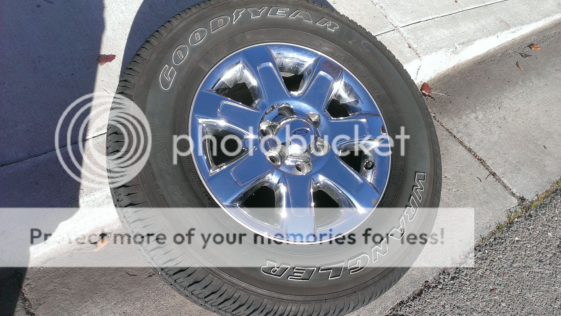

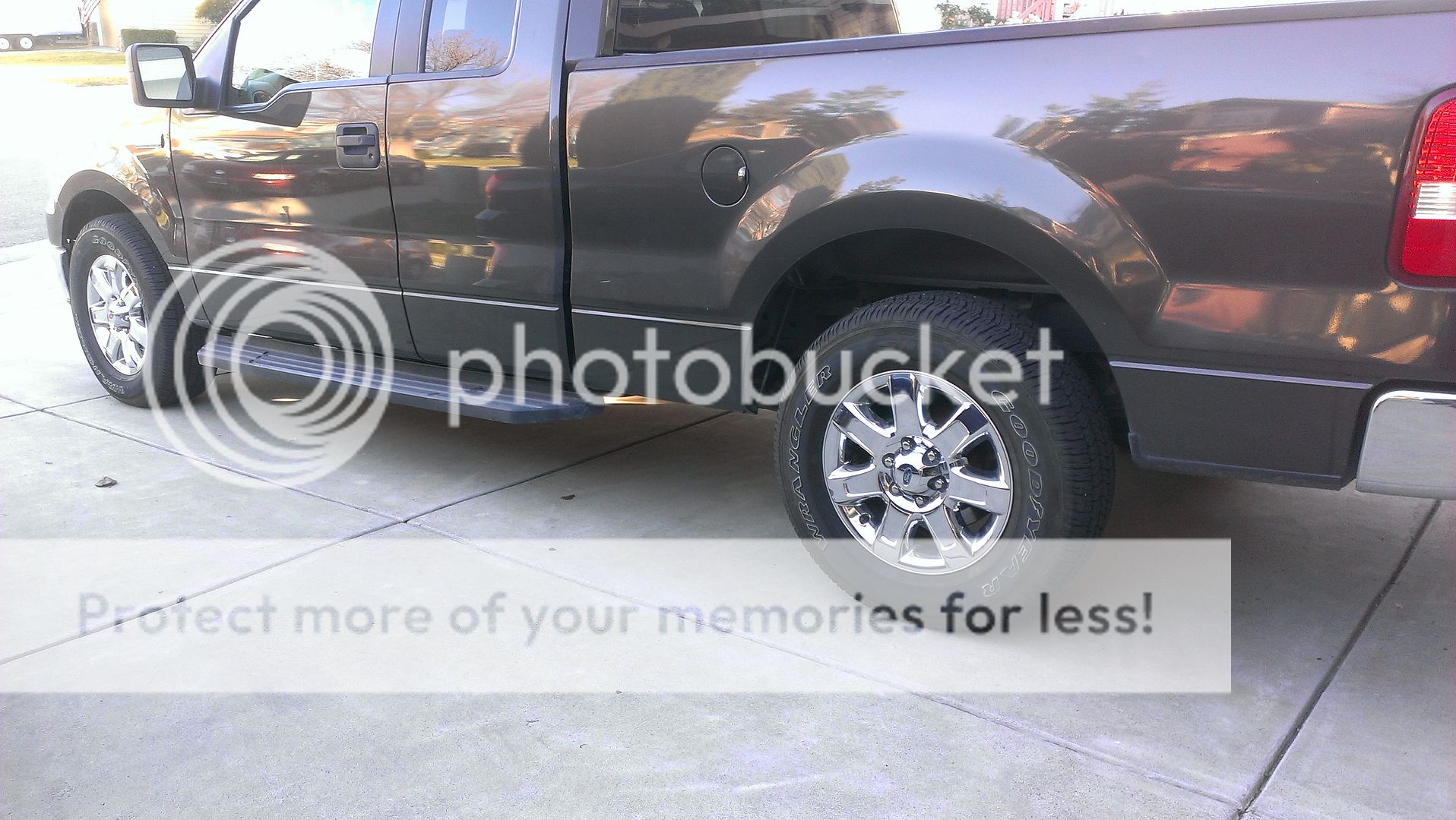

my neighbor came home with some new rims and tires for his f150, joking with him I yelled out "I wish i had some new rims" he walks over and says I'm about to put these on craigslist for 500.00 bucks you want them? 6 month old tires 2013 upgrades factory rims... I said "hellya I do"... I needed two front tires and it was gonna run me about that anyways. This type of stuff never happens to me...
I hopped on it...
That was just too hard too pass up! :D
