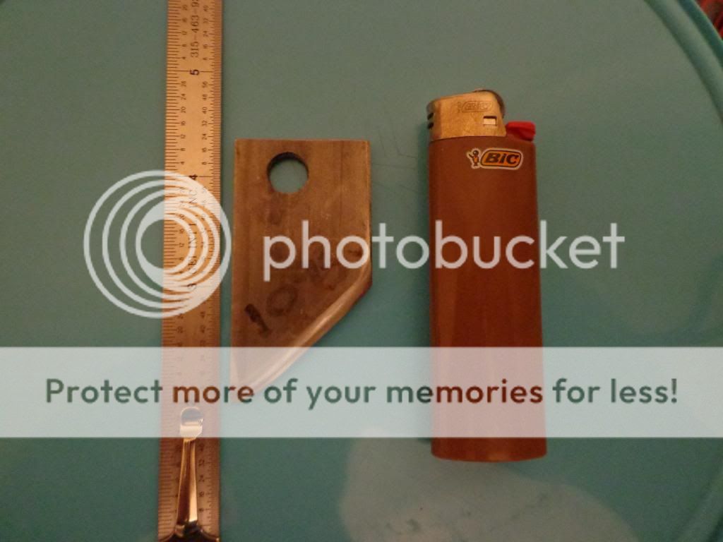

Oh and James, not sure if i told you this already or not but since im looking at it right now...
A few days ago i got a rough edge on the piece of 1095. It was still harder than i thought it would be even though its not hardened yet. I used a file to get the rough edge shaped on 1 side but that was taking a while so i cheated and used the worksharp with the course belt to finish it off. I will prolly continue with it and try and get a scary sharp edge on, right now the edge is still pretty dull but will cut into wood. I filed into the elmax as well, its not quite big enough for me to get an edge on it by hand but i did do a little filing in it to see how hard it was too.
Thanks again James, its a great learning experience and makes me appreciate the work you guys do even more now that i have a little better idea of what you guys go through.
Now once im finished i just throw it in the oven for 4 hours on 350 degrees and then drop it in a pot of crisco and that should put it at about 58hrc correct? :D LMAO
Not sure if you're being serious but are you making a knife? What you just described would be the tempering process...You first have to heat it up to non-mag and leave it to "soak" a little then quickly quench it. After that you chuck it in the oven which should relieve any stress, remembering that when quenched, the blade would be at its full hardness and any pressure or stress applied to it could cause it to snap.
this won't work. It won't hold an edge when it's soft. it WILL be instructive, tho. :D
Besides, the edge is the VERY LAST thing you do to a knife. You want to leave the thing dull, and by dull I mean a nice bright, flat 0.005-0.015" thick 'edge' at the bottom of the primary bevel with NO secondary, until EVERYTHING is done. shaping, heat-treating, polishing, handling, sheathing, etc. Unless, of course, you like cutting yourself. Pointy blades are dangerous enough to work on without a damn scalpel hanging out in the middle of your work while your hands swing around it.
LMAO, i was just kidding about the oven and the crisco :D I wouldnt try and heat treat anything in my home for real.
Its just a small piece of steel, James sent it so i could get an idea of how hard it was before heat treat, but since i got it i figured id try and get an edge on it. I wont be getting it heat treated or anything for real just playing around for the learning experience. The very edge shows on my caliper at about .023 and right behind the edge is at .115" right now and the steel is .125" stock
