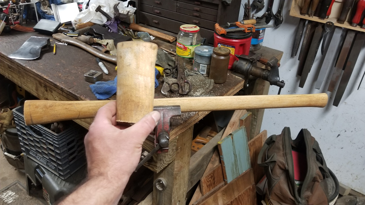

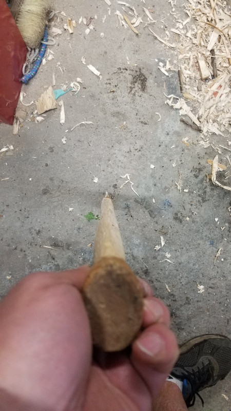

I started with this 36" mattock handle...

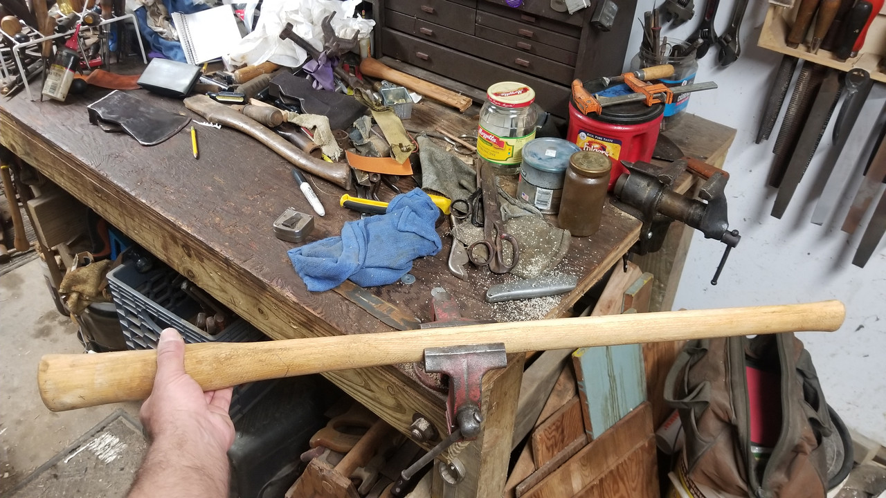

Cut it down to size (which I soon learned was to much-needed the wood stretcher but couldnt find it:D)
Started to slowly carve a single bit tongue, swell and realized the haft had a bend

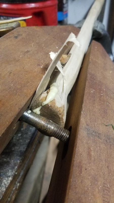

I roughed the handle out...very rough...and had my first steam straightening kitchen party...
Clamped it, slightly over clamped it, along the bench leg.
That worked great!

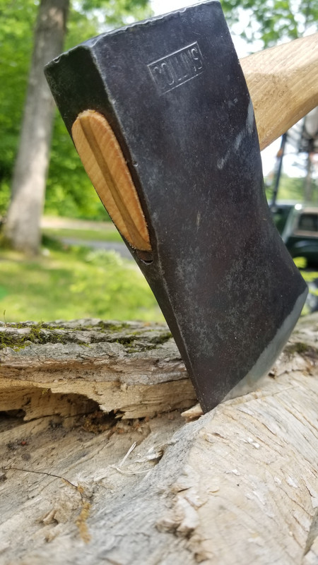

Starting to dry fit the chosen one...
A minor set back but turned out solid and secure

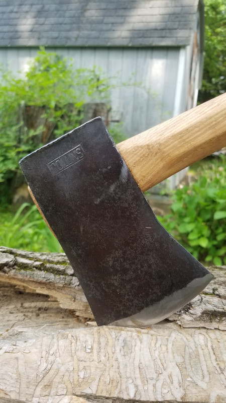

Collins boys axe - 2 1/4lb head -
Originally a 36" mattock handle - widdled down to an octagonal desired straight, now 26" and 3lbs total.
My first real attempt with a drawknife and first attempt other than thinning and accentuating the shape and curves of a replacement handle.
Thought my unusual amount of mattock handles in my barrel...over a dozen...would make good practice and make good handles :thumbsup:
Can only improve from here...:rolleyes::)
Well done!
That's really all it takes for axe handles. Easy to straighten.
Thanks. I was unintentionally heavy handed with the drawknife, but all the gouges and run outs have taught me a few lessons and the next one should teach me a few more ;)
The steam and time in the jig were all less than an hour and the worst part was having to wash the pot:thumbsup:

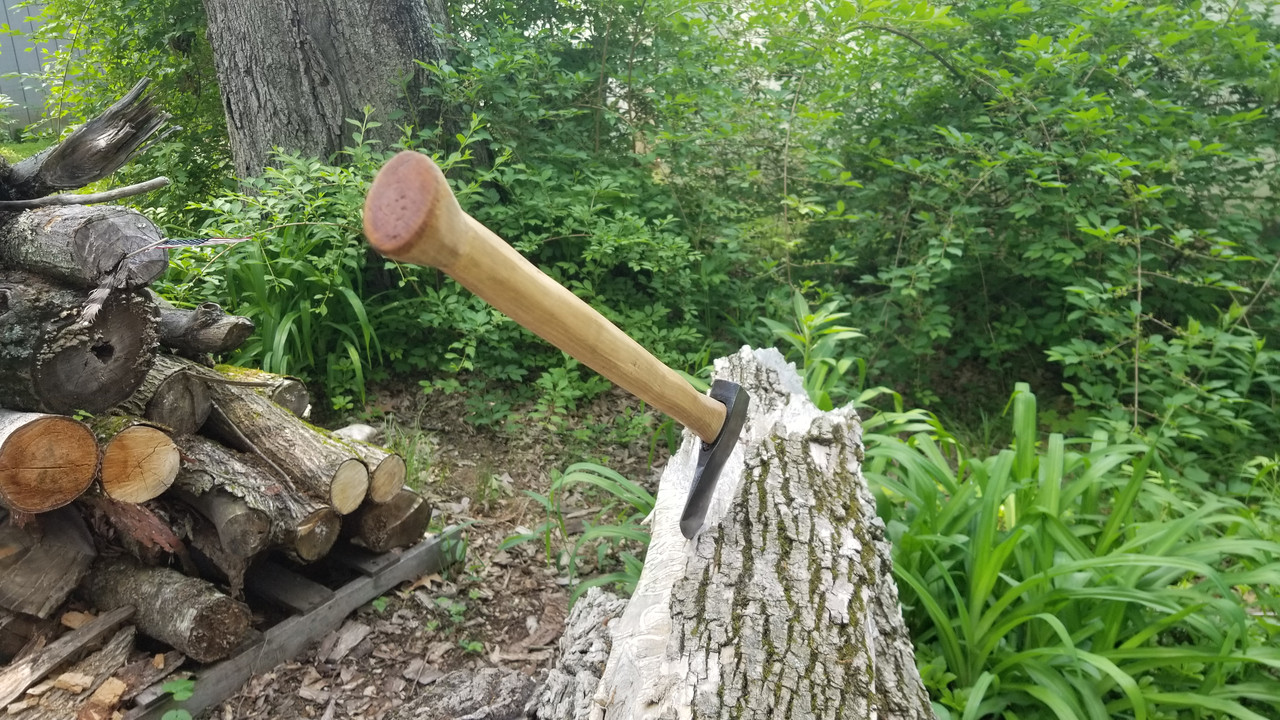

Tonight I spent some more time revealing the maul handle hiding in this hornbeam stave. My wife and I recently moved out of our apartment to a cottage on the lake, and man what a relief it is to get out of the city. The view while I'm working has certainly improved.
Liven the good life, even have an answer for the mosquitoes. Handle is coming along nicely too...
