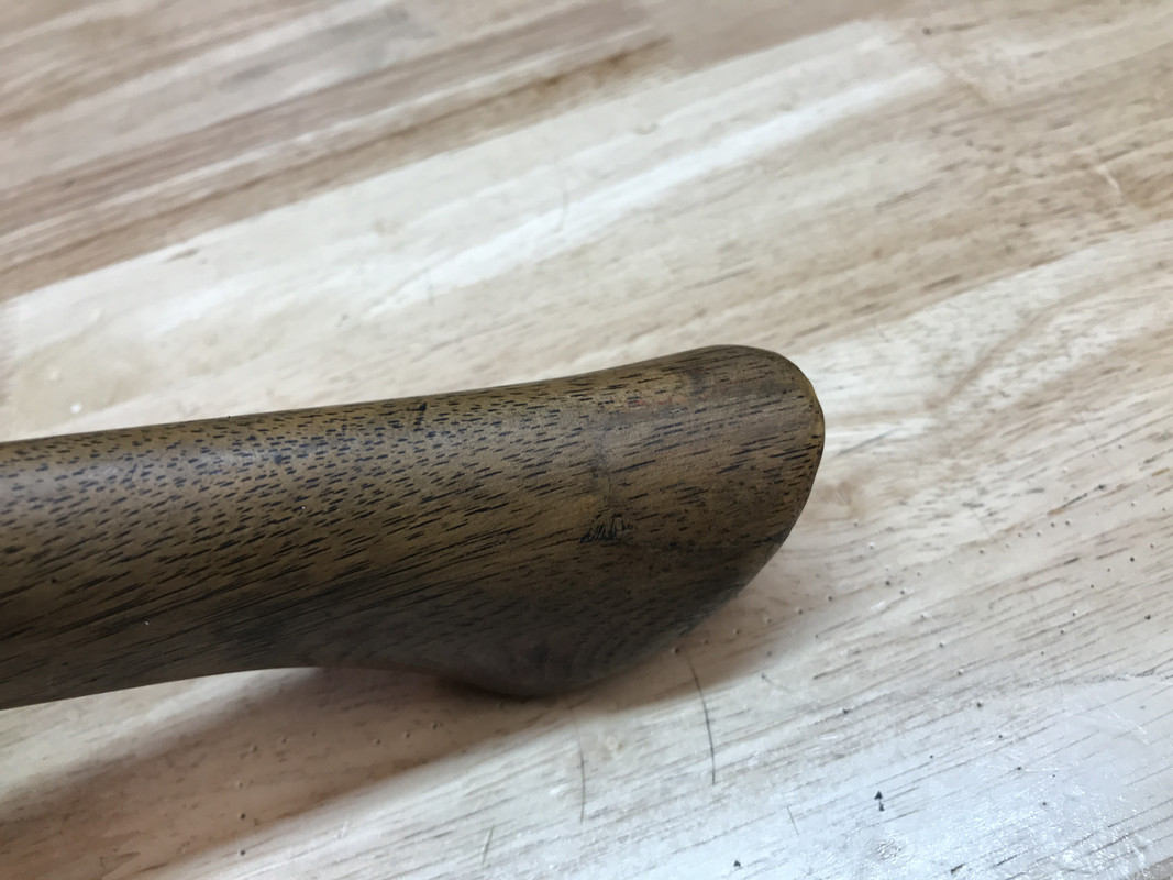

It's a gnarly piece of hickory. Tension, twisted grain, harder than a lot of tropical hardwoods I've worked. Obviously the tongue area is ambiguous, I'm not sure what is going on it and how far down. It's quarter sawn, so it's not the ideal orientation. But I'm not worried about this particular piece of wood. I forgot to mention this is came out of a 48" 8/4 board, I think it's the 5th haft from it (last long piece, hence quarter sawn - no room to rive). Lots of chips, shavings, and swarf. Had a real close shave with a intergrown knot, too. More to come, but it'll be in the 'what did you hang today' thread.
That's tear out at the top, but plenty thickness left to shave it out, still.
And yes, as usual I'm on the same page as YJ. It's a good release. It's like shaping a chair leg except you can freestyle it and go with the flow, rather than having to worry about matching the other three (or more for a set!) lol.

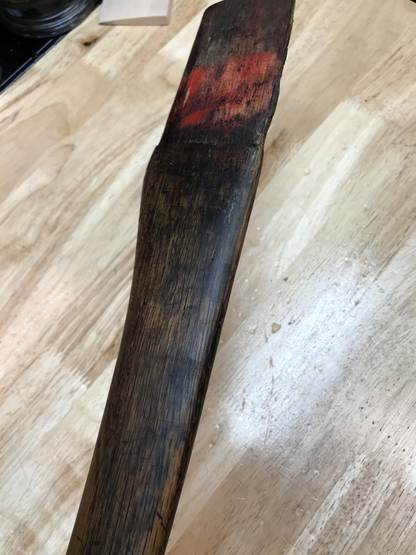

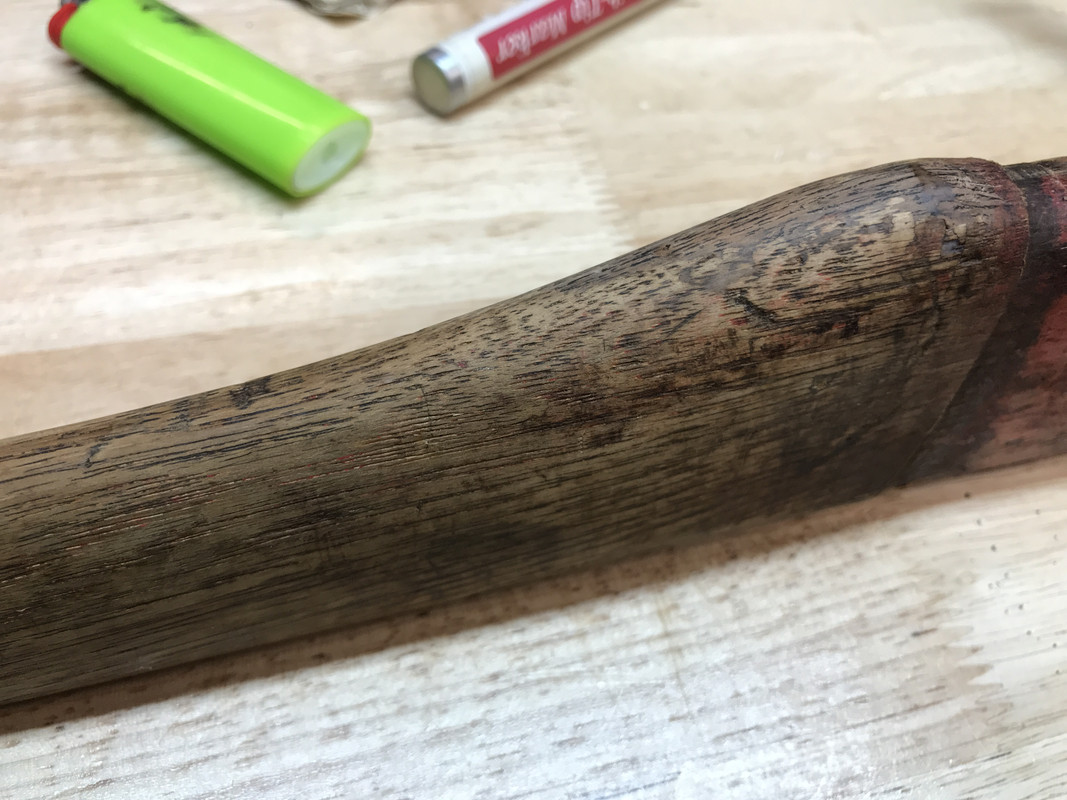

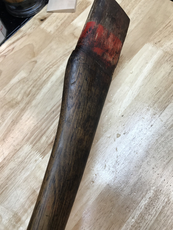

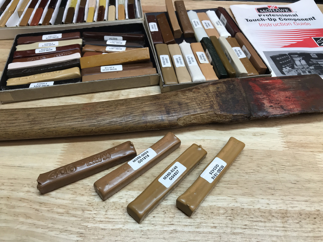

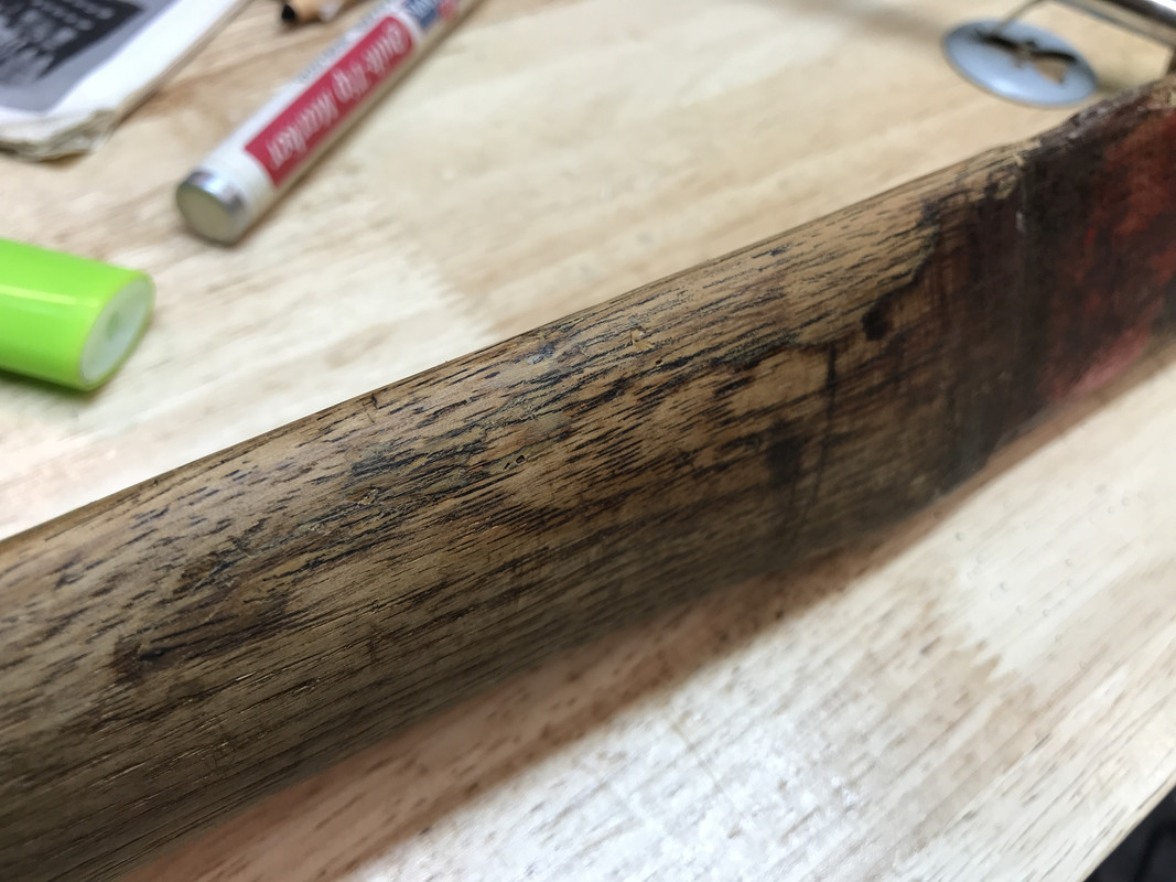

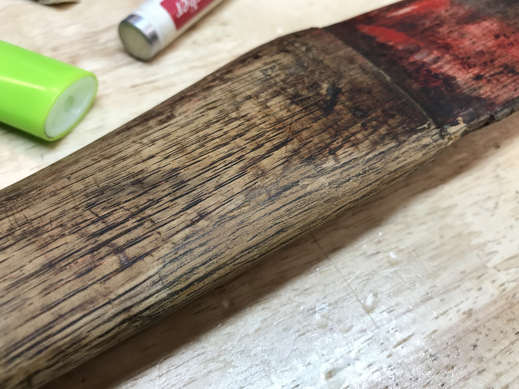

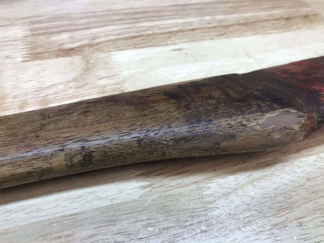

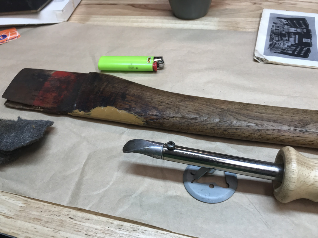

Before I rehung an axe on this handle I thought I would try a melt-in repair for overstrike damage and misc gouges. This was really just to get in some practice with the Mohawk touch up kit before an important and technical repair to a piece of built in furniture at work.
But I was fairly pleased with the results considering that I was just kinda messing around with it to see what I could do...
Super hard waxy sticks.

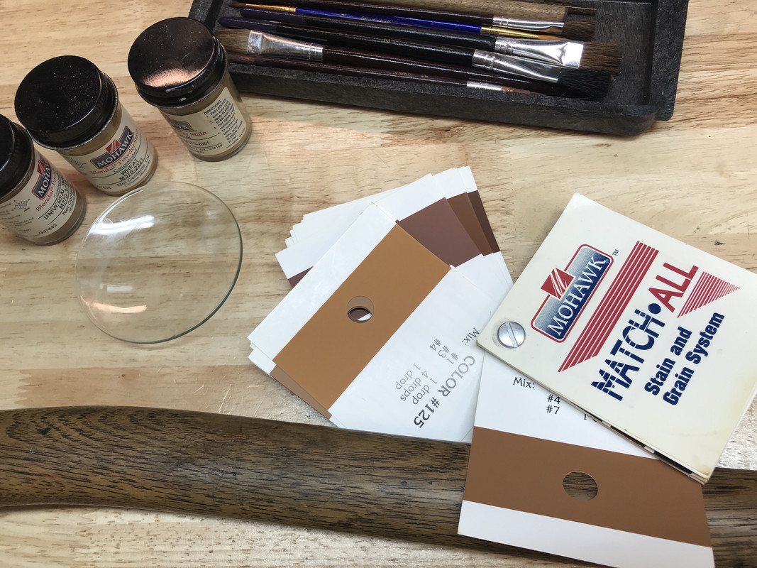

Melted in, preferable without a flame but you know. Then I put burn balm on the surrounding wood and use the curved tip iron here to smooth it in. (The steel wool is for cleaning the iron.)

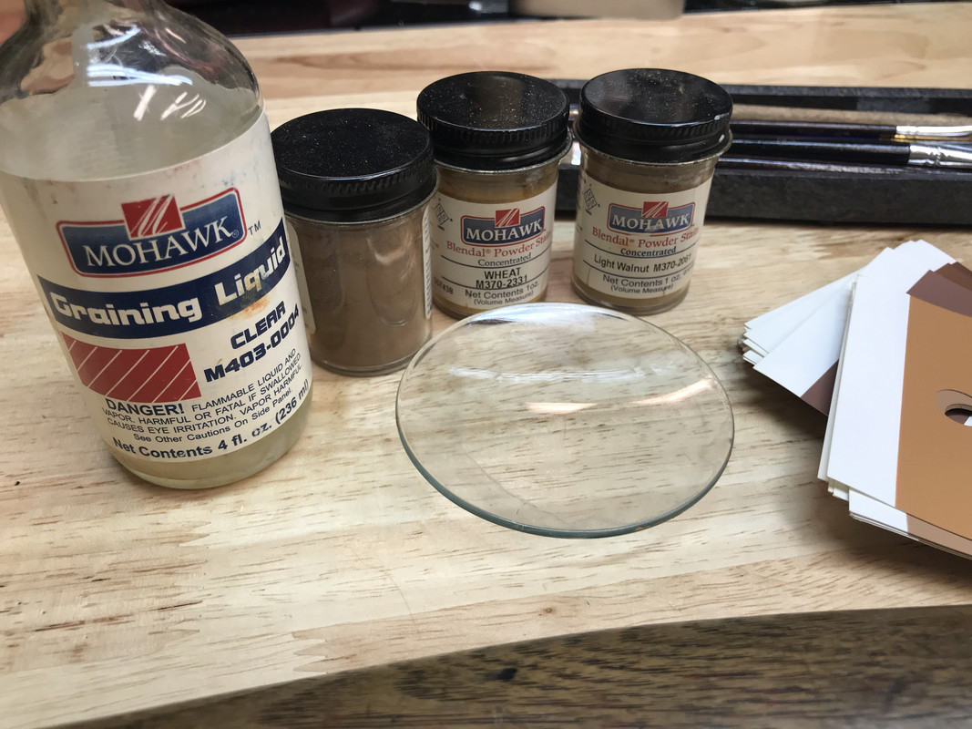

Then sanded of course, and used a variety of graining liquid and graining pens to fake-in some grain.

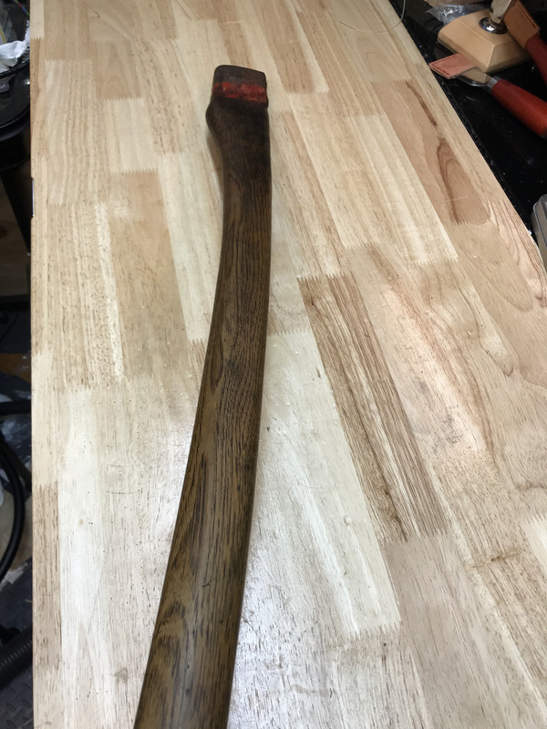

That’s about it. For a furniture repair I would clear coat it with finish and maybe use graining liquid to blend in the light areas. But for this I will use black antiquing wax to help obscure the repair and return some of the color of the pitch I sanded off of the handles shoulder. After wiping off the excess I rubbed the whole thing with vintage axe wax.
This whole process took less than an hour.(more like 30 minutes actually)
“If your only tool is a hammer...” right?

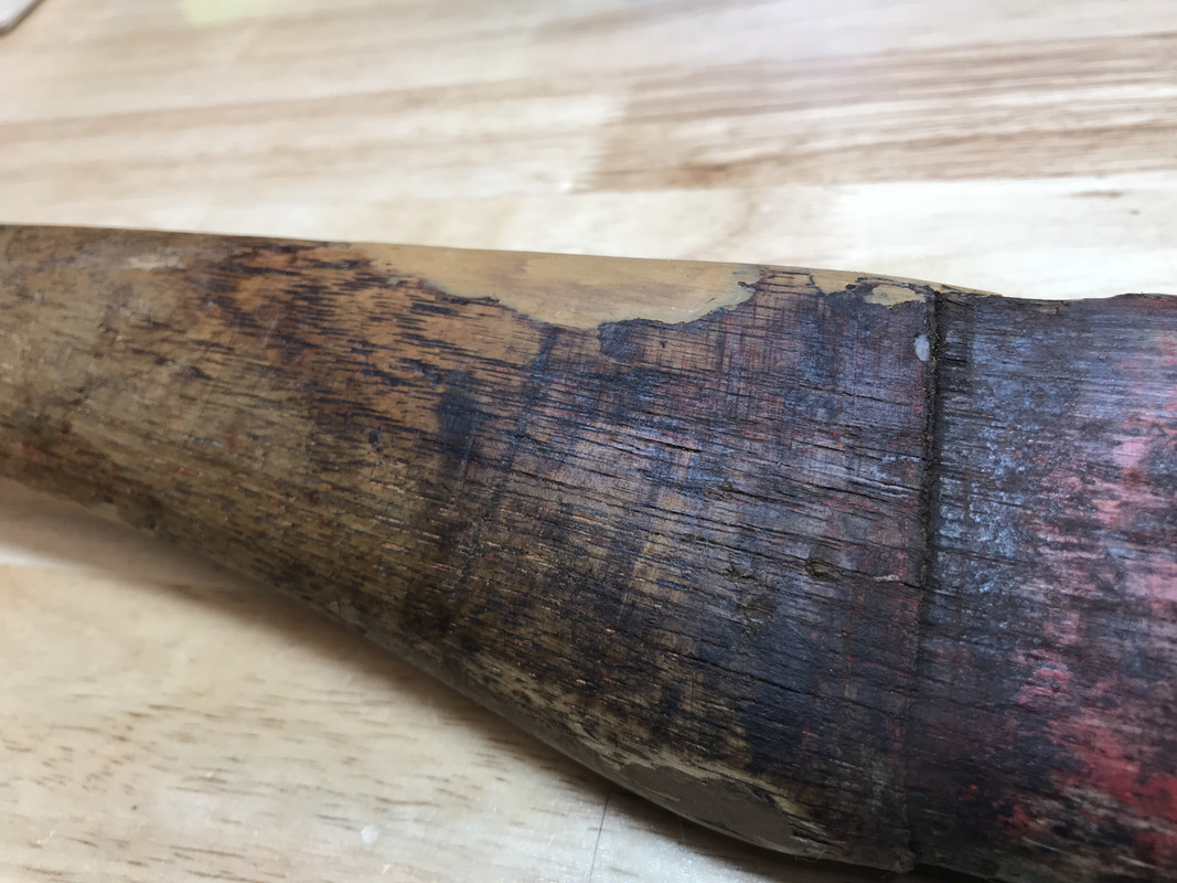

That is awesome ITVD! I didn't know that stuff existed... Once it's set up how tough is it? I mean is it hard after set? And does it take stain like the surrounding wood? I have a very nice 30" haft that's all but useless for a full size axe due to over strikes. 15643512351665473935006862176130.jpg I may need to get me a(some) mohawk... I just hate to lose this haft...15643513661441390789585996395623.jpg
Beautifully done repair by the way. Inspiring in fact!
I’d consider it an aesthetic repair and would not count on it to return any strength to the handle. It’s like a plastic, hard to put your fingernail into but you could snap one of those sticks in half.
This also doesn’t allow it to soak up any stain. It’s all faux finish.
Once you draw in the grain if you need to blend it with the surrounding stain you would use this graining liquid and mix it in this glass dish with a toothpick full of the appropriate Blendal power.
You can hold the glass dish over your piece to see if the color and opacity are where you want them before getting in there with an artist brush and stroking it out.
I see. Thanks for that. I'll probably end up cutting out a rectangular chunk just large enough to remove the damage and replace it with hickory in that case. Still though down near the swell or as in your case that makes a damn fine repair. Looks great! It's nice to know there's options!

There is some stuff that I use regularly as part of a repair for large voids in rotten wood called SculpWood. It’s and A&B epoxy putty that is formable, sandable, drillable, etc. I have thought about trying it on an axe handle before... It would provide added strength!
