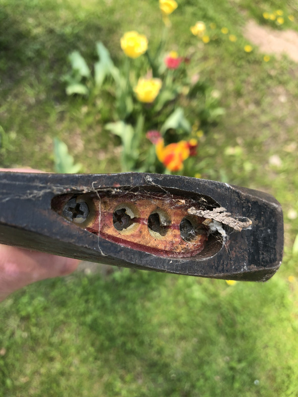

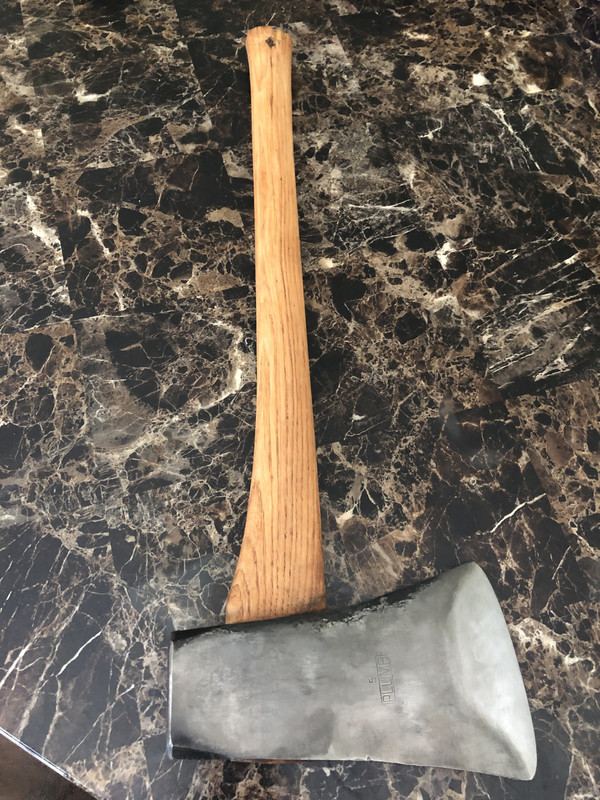

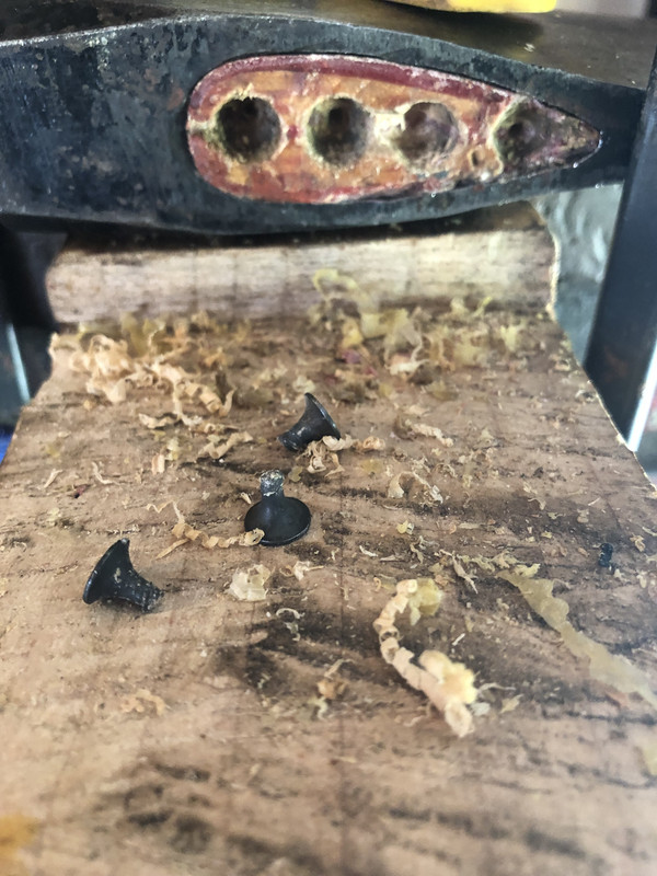

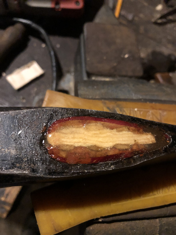

Took a stab at keeping the handle on this Plumb.Had to glue up some splits in the swell didnt take pictures but I used tite bond 2 and left it clamped a couple days.Chiseled under the head and smacked on the swell until I got it a little bit proud,broke all the screws and drilled them out best I could then drilled a couple shallow holes,split it with a wood chisel and wedged it.Whittled some little plugs for the spaces beside the wedge then poured epoxy in them until it guit going down then hammered them in and sawed all the wedges off put more epoxy on top then let it dry four days.Big wedge is ash from the east coast lumberjack I beat on it with a six pound hammer and it didn’t break.The plugs are poplar and the epoxy is t88.
