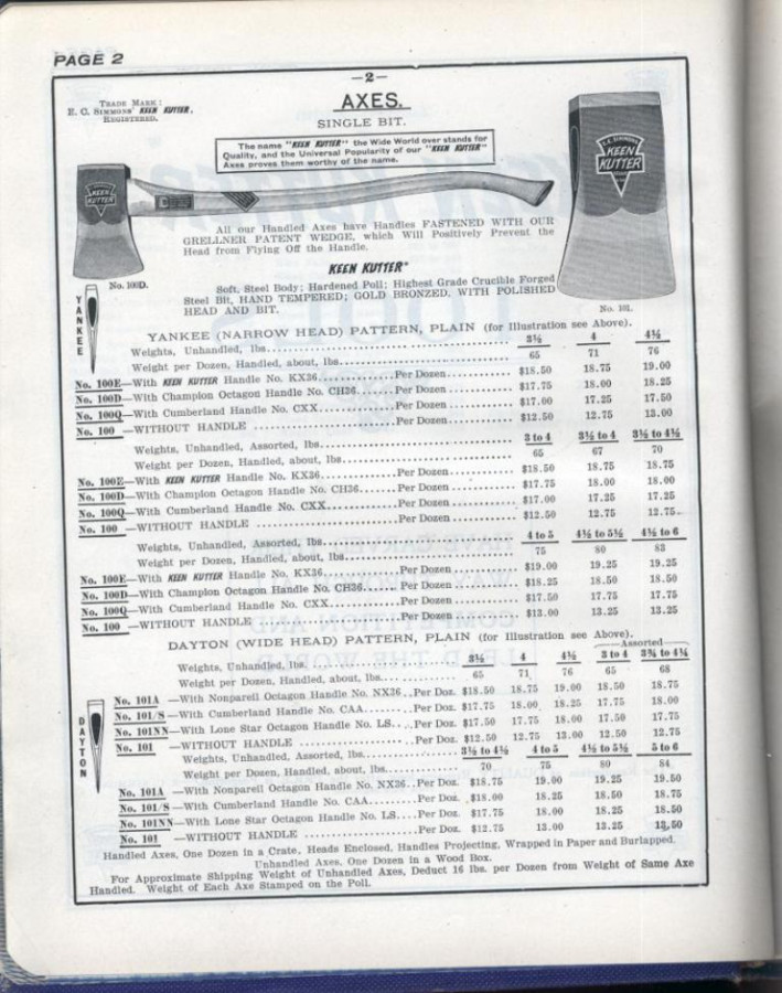

I respect your opinion, M3mphis, but we here in the NW don't encounter very hard woods as frequently as folks in other parts of the country do. There's a reason why the Carolina pattern axes are narrow - they got hard wood down there.
The Puget Sound falling axe was designed long and narrow for cutting springboard notches in big Doug Firs that could have bark up to 6" thick. But the narrow bit mimics southern hardwood axes so it's a good choice for VCB's application.

Here's a North Carolina pattern, from American Axe and Tool:
Besides the Carolina pattern I also suggested a Yankee pattern (if you can find one). Georgia pattern is also narrow. But all of those are hard to find. That's why I suggested the PS falling axe. Plenty of those still around.

I've looked for Georgia, Yankee, Carolina and Kentucky. The only thing I found was one Kentucky on EBay and it looked like it had a wide bit. You appear to have saved me a lot of frustration by suggesting the PS. I think I was lucky to get the one I bought. It should be here next week. I was looking in Lowe's last night for wood stain and decided to check out the ax handles and they had an Ame's hickory handle for a double bit. I was shocked to find that in So. Cal.
