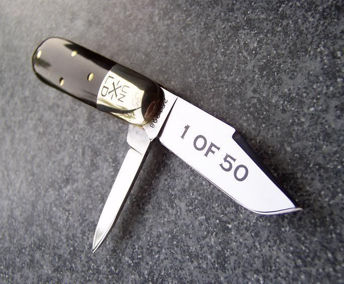

Here's one I got last month from a good friend and forumite here, a GEC # 25 in Red Buffalo Horn scales..
Good choice, Anthony!! Nice in Horn!!
I couldn't resist a couple of those #25s!
