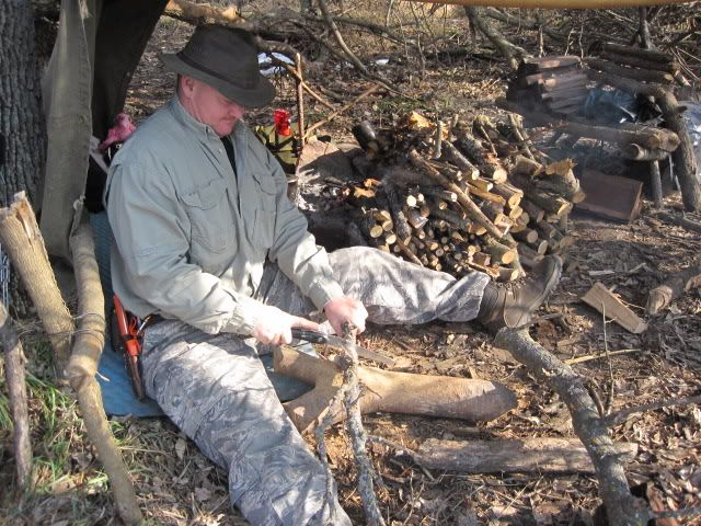

How many of you can walk out of your home right now and grab a stick thumb thickness or so that is off the ground and start to shave it with your knife making up a fuzz stick or even just shavings and then start them shavings on fire?
I have done it after a 3 day rain here in Nebraska to show my nephew that is can be done. Remeber the out side of the stick is damp but the whole inside is not. Once you get a few shavings started you are right into the dry wood. So I can tell you right now right here in my area of the world I live in a hard and soft wood area. I would never have to batton a single stick when I can just start carving up a fuzz stick, but I do because it sure makes getting hearth boards easyer, and it sure is fun to do when I am sitting next to my fire. I like to split small round that I cut with my saw
and then batton/ split
them and feed that spit wood into my fire. I am not trying to spilt 5" thick hard frozen wood with my 5.5" knife. Although I have seen some do that and I think that is really asking for trouble.
As you can see I do not need to split that thick of wood. I have travled while in the Marines and I so far have never had to do that then either. I do not tackle thick wood with my knife the thickest I split is that wrist thickness or so.
There as to be some thinking done here guys. There are some who think they are going to jump behind emeny lines, attack a tank with there knife and then try to kill the driver with that same knife. I kid you not I have chatted with some who have called me on the phone wanting me to make them a knife and tell me that type of stuff. I tell them right then and there I am not the maker you want you need Gil Hibbon or some one like that who make fantsy type blades, I make a working man / woodsman type of blade.
I have been making knives for 3 years now and I and I bet I have told callers that 15 or so times. I was even chatting with Brian Andrews a couple of weeks back and he has had that typr of stuff asked too.
There are some real arm chair Commandos out there.
So really how many NEED to batton there knives to get into some dry wood or couls you just pic a stick from off the ground and start shaving that stick?
If you only for some dumb reason had one knife ( I normally have 4 when I head to the woods which is most every day becasue I take Kelly Girl for her daily walk in the woods down by the river near town) would you still do that and take the chance of it being that one time and breaking?
Just wondering how many will stay say yes;) lol.
After all that I just said I bet most of you could just grab a stick and start shaving it up.
