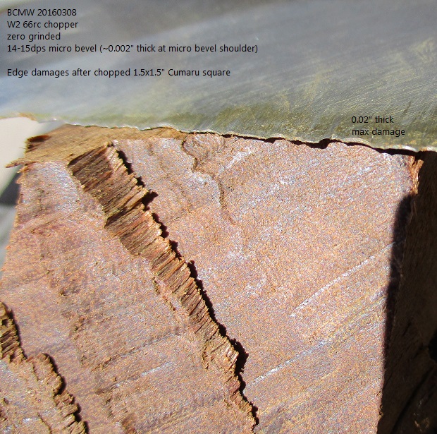

I agree, convex/apple-seed blade grind would takes less work and stronger too. I am looking for limits on what an insufficient strength edge (not enough steel volume) against very large impact/impulse forces. A heavy chopper can put a large impact load in small area and with ample momentum where steering can lead catastrophic damages.
When my new order of steels arrive. I will make most 0.160-0.175" thick 7" blade (12" OAL) test blades - I can zero grind these to magnify failure situations.
What if you tired doing a convex grind instead of the flat?
Not too bad eh :cool: I will test this chopper(same edge area) - zero grind (6 dps), 12 dps (shoulder 0.006" thick), 15dps micro (shoulder 0.002" thick).... Goodbye chopper!

full zero grinded (6dps) the chopper and a very small 15dps micro bevel - very hard to see with naked eyes.
Edge after chopped 1.5"sq Cumaru wood(15th down from this list - https://en.wikipedia.org/wiki/Janka_hardness_test)
* max damage thickness extended to 0.025" after chopped 1.5"sq Lignum Vitae Argentine.
Edit0: Chop-exits exert quite a bit of lateral forces on the edge
Edit1: 52100 63-64rc jb, 0.02" BET, 13dps. Lignum Vitae chopping tests: passed
W2 65.5rc jb, 0.025" BET, 15dps. Lignum Vitae chopping tests: passed
52100 63-64rc jb, 0.015" BET, 13dps. Lignum Vitae chopping tests: passed. African Blackwood - passed with a few micro deformations (looking through 22x loupe).
