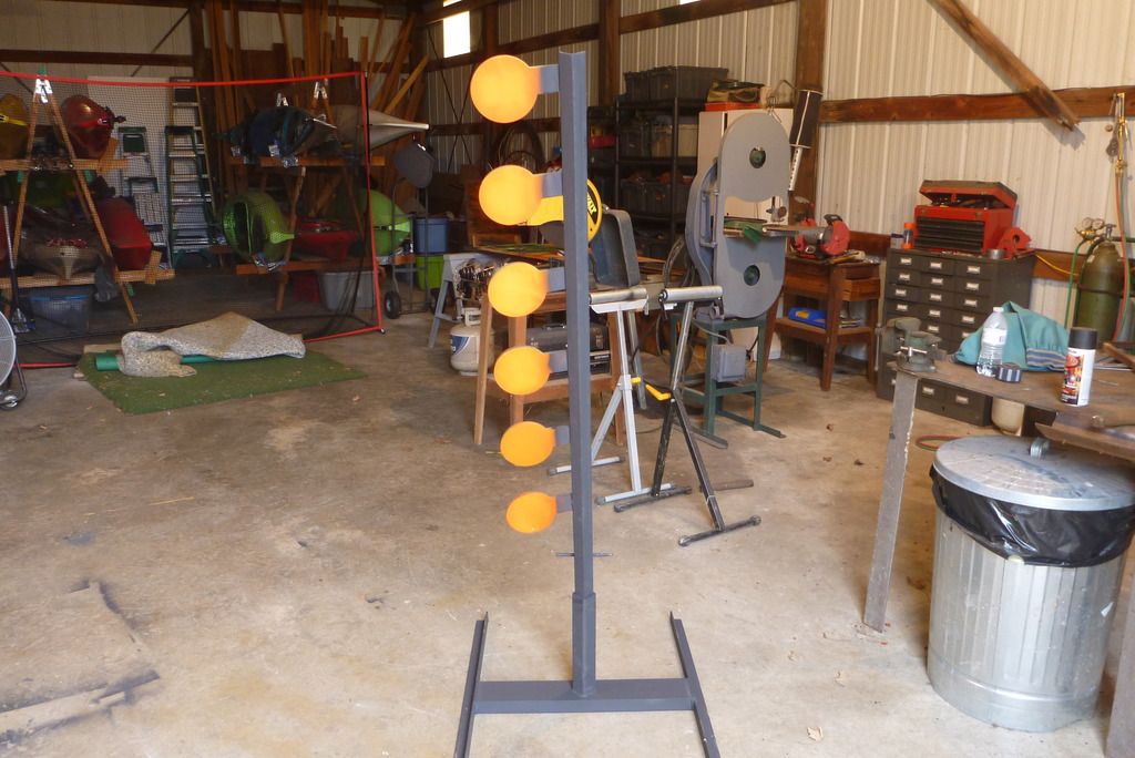

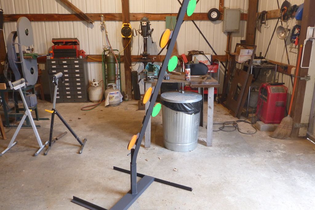

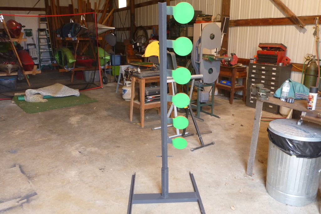

the other way I've seen for making sure the plates don't free-float is to cut the pipes at a shallow bevel with the high point centered in the back so the plate has to ride up just a little to swing.
I've seen that too Vik, I like the deflection at closer ranges. I doubt if I can hit it past 7 yards. :D
Been burning some rods.
Cool! I found that turning the angle edge on only goes so far to deflect rounds. Any mild steel becomes sacrificial because a whole bunch of hits will just dig right through. I guess that's the price you pay. They look good Tradewater! :thumbup:
Of course, all the hoodlums I have surrounding me seem to aim at the stands I've made... :rolleyes:
That's awesome you made that trade!! I would love to get one of those!! Nice work mang!!
