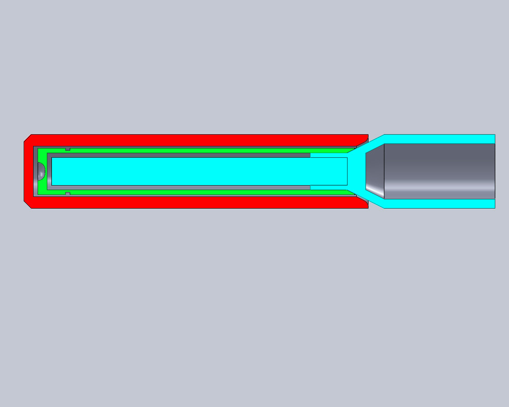

In the spirit of compromise, and the acknowledgment that others may disagree with my views on fire pistons, here is a hybrid of the two. No idea if it would work, but it is at least symmetrical.
The turquoise/blue-ish region is the firesteel and end capsule storage thingy.
The green is the fire piston plunger sleeve that fits over the firesteel.
The red is the fire piston base.
Not shown is an endcap that would fit on the end of the capsule portion. There would be threads in key places, obviously, like where the green meets up with the blue, so that the piston mechanism would be stable. Maybe some knurling for like .5" at the end nearest the firesteel on the outside of the green so it would be easier to remove. And of course threads on the end cap and inside of the end of the capsule portion.

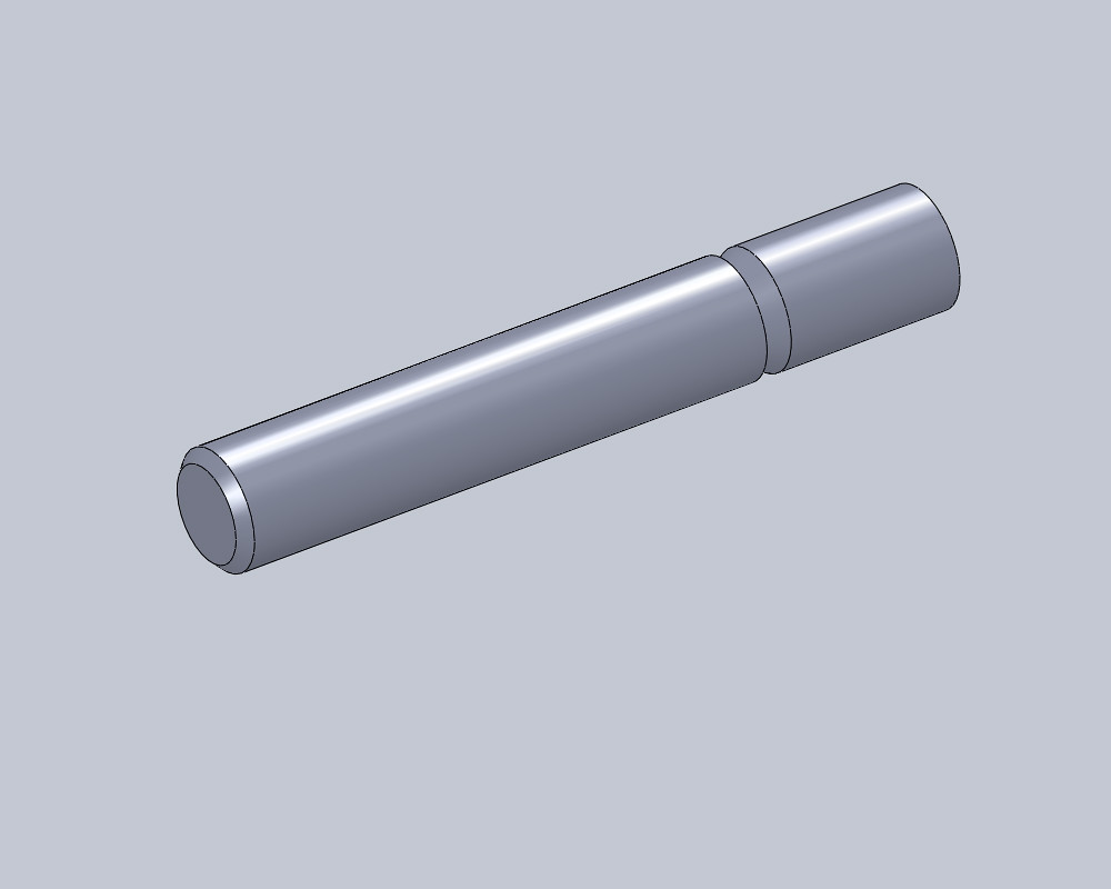

A pic of the outside, for poops and giggles.
Overall length with an endcap in place would be somewhere around 6.5" or so.
