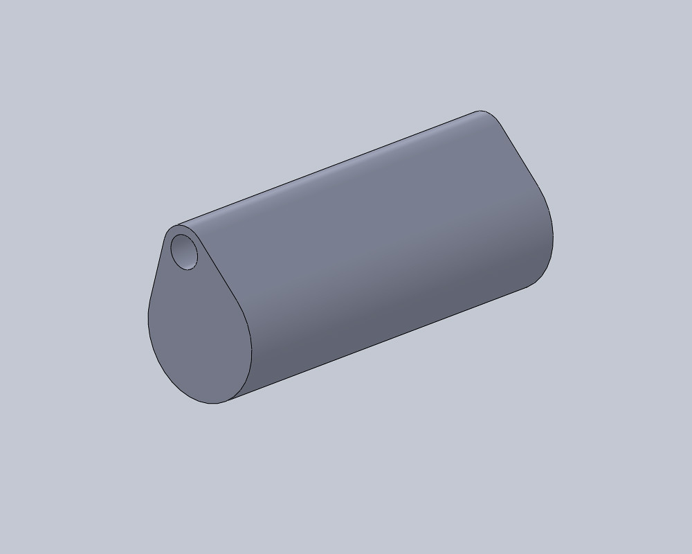

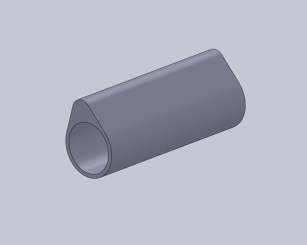

This is the best of what I am able to come up with. It depends on Flexxx (or whoever) being able to drill and thread it even though the holes are off center. More of the device is held solid while the drill bit is rotated into it sorta thing.
Imagine at the end of each tube piece a threaded cap that fits into it. The one for the steel could of course be attached to the firesteel itself, and be reversible. Length of this is ~4.5" and height is just under ~2" with width at ~1.25".
