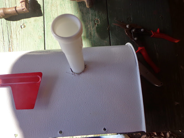

First things first, I needed to cut a hole in the side for my burner.
Right about there looks pretty good. I used a length of 3 inch pvc for my chamber. The mailbox is roughly 20" deep.
I couldn't find the chuck for the drill, so I used an old hand drill. Found a 1/4" bit and used tin snips to make a relatively round hole big enough for the burner tube to fit in.

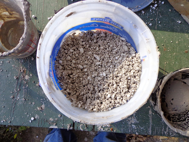

I read that the proper mixture is 4 parts perlite to 1 part cement. This is what it looked like mixed together.
