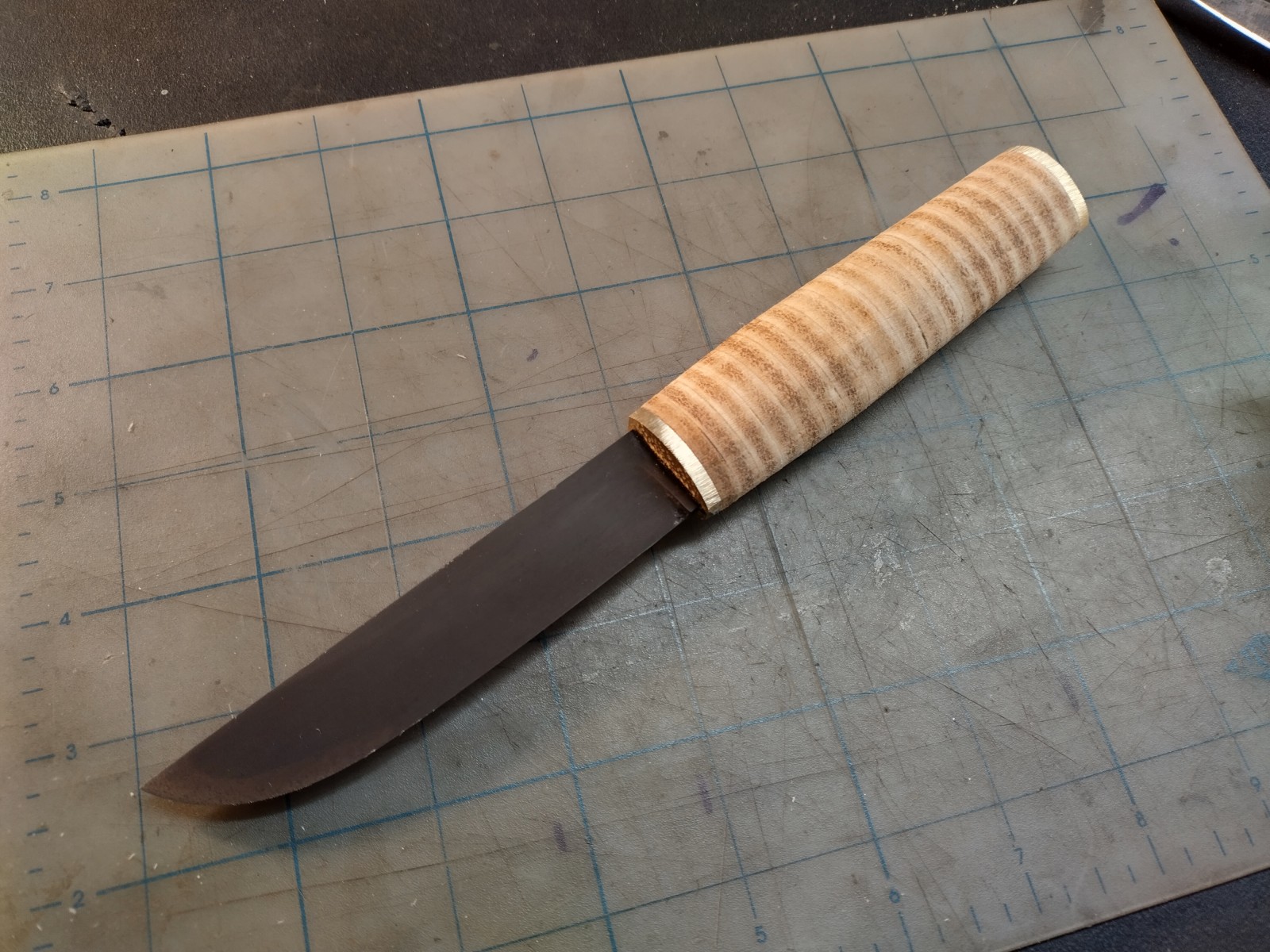

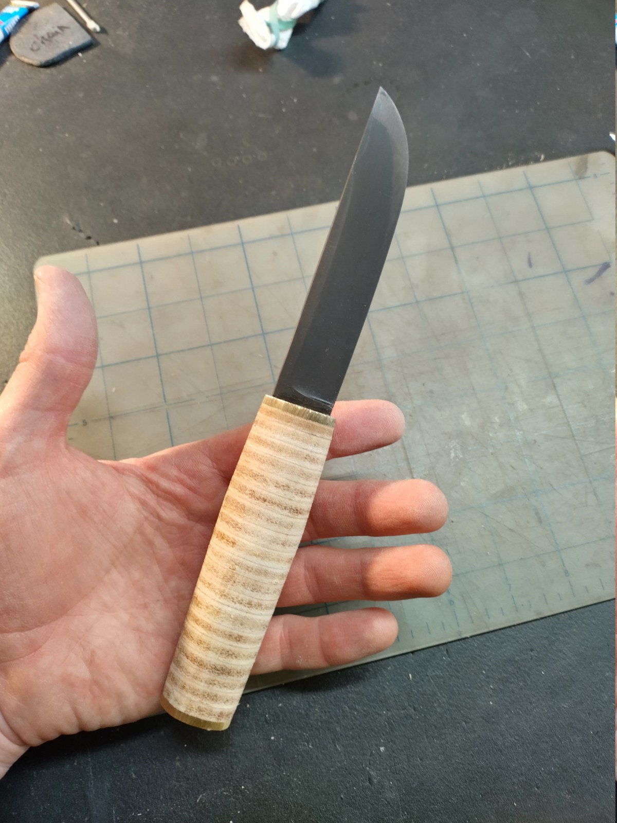

Here's some progress on a WIP that's been in the drawer for YEARS.
This is shaped at 36grit, so there's still a bunch of finish work to puzzle out.
And the sheath... I dread the sheath. 1084 at 61Rc:

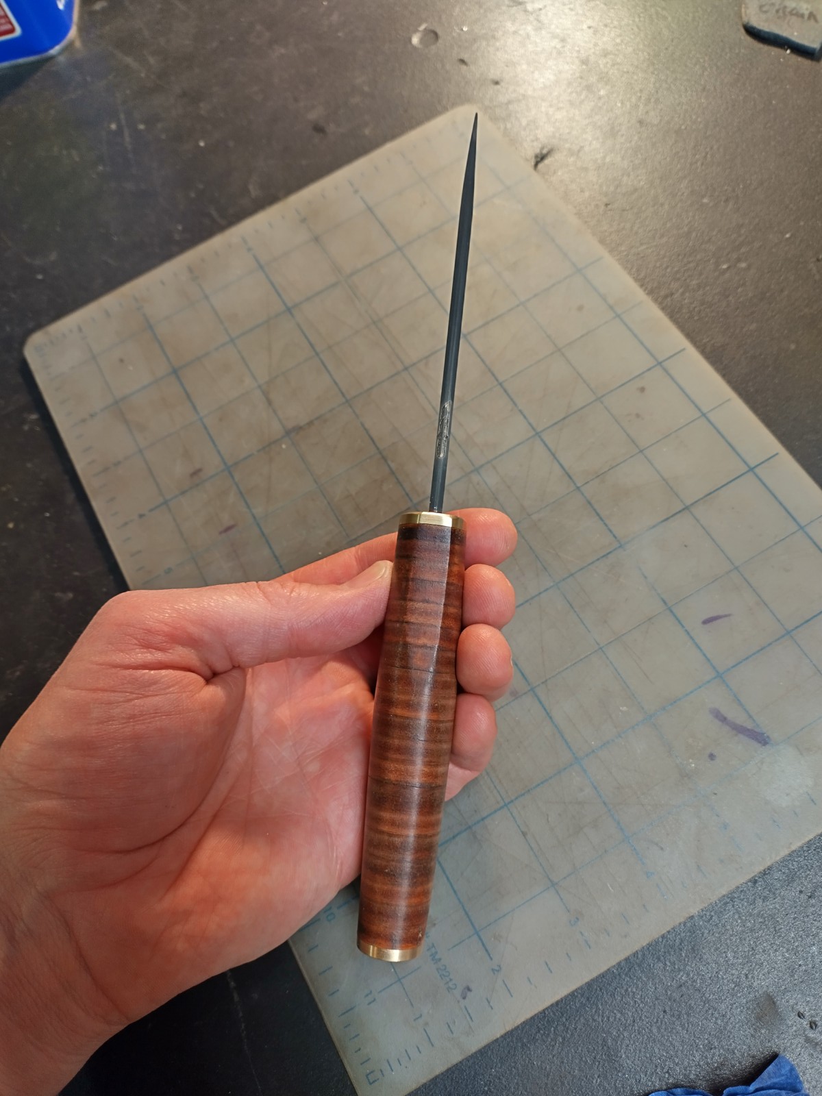

holy moly, I didn't expect THIS. Hot beeswax, heat gun, cotton hand-buff:
Would you say that entire process was relatively easy?
It's on my to do list.... I like how warm and rich your handle turned out
I love the color too. No dye at all (leather edges always end up darker than the faces anyway).

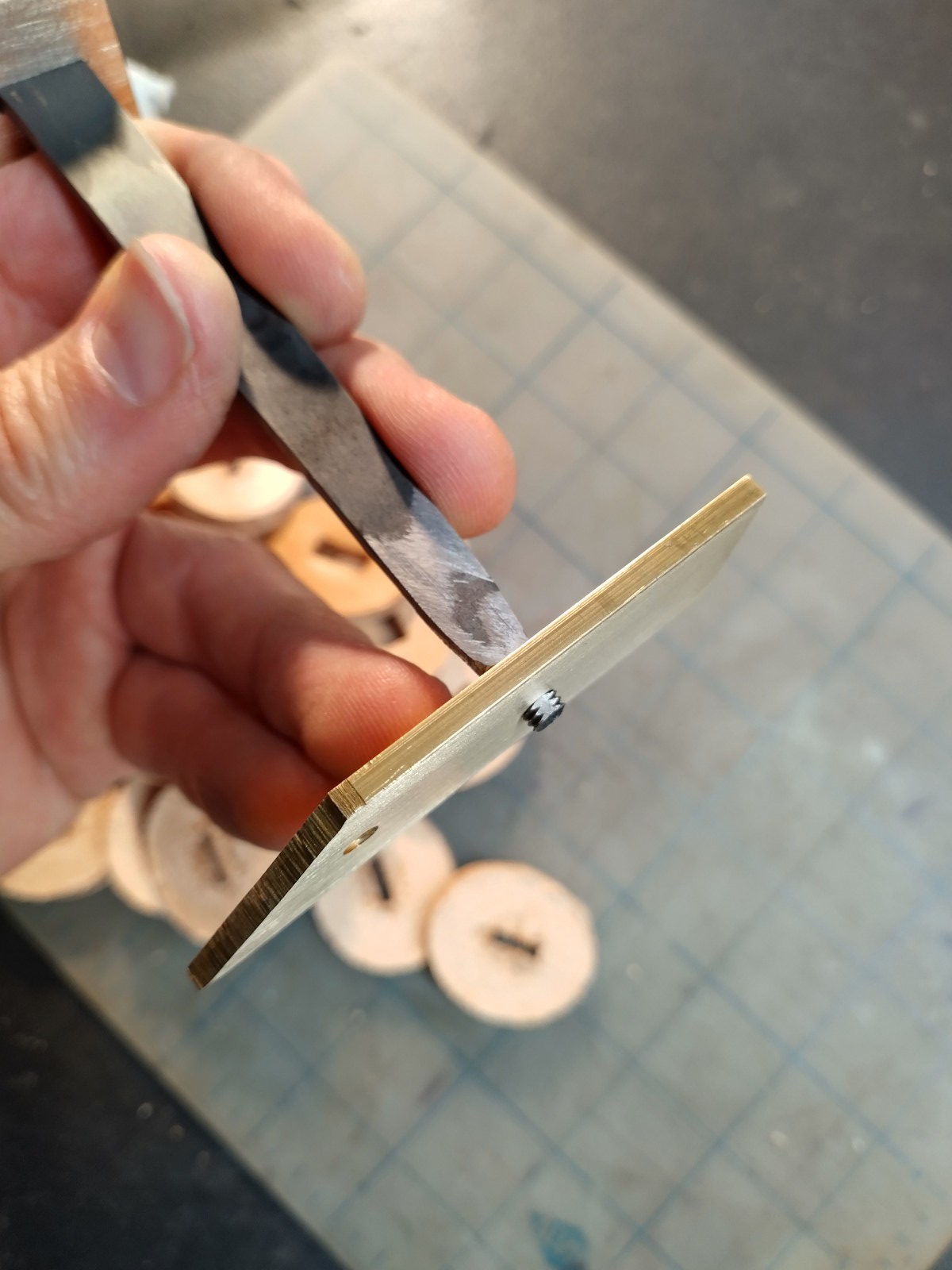

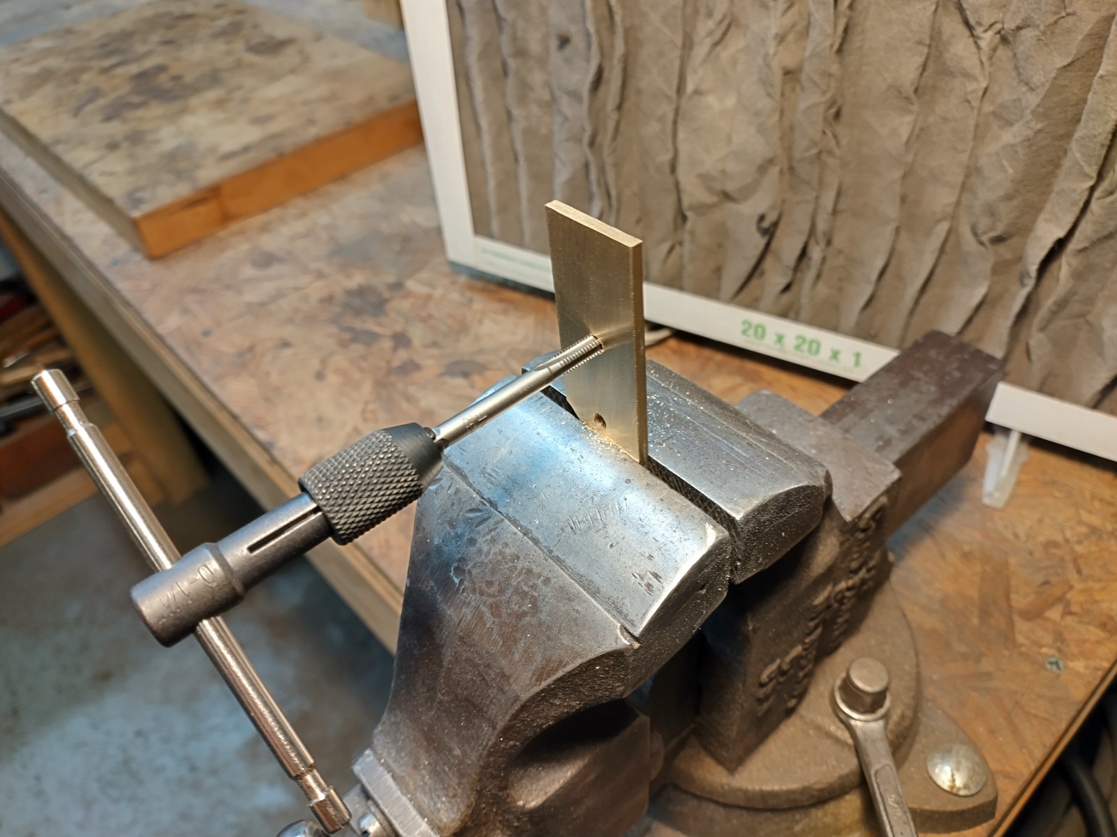

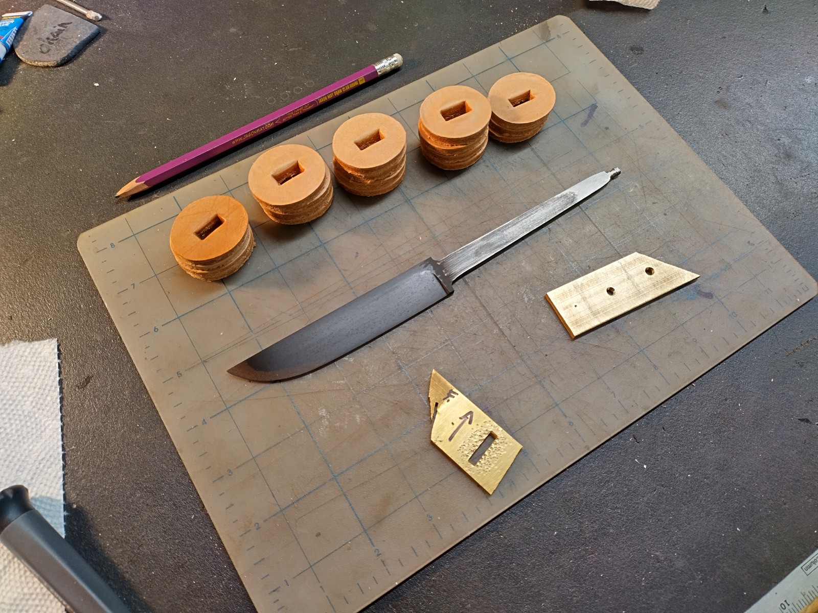

Well... a number of thoughts.
* Leave plenty of room for compression.
* Consider stacking and gluing a block, then drilling lengthwise? I don't know. I used the Kabar rebuild washers and had to slop every one with glue on both sides, which was gross. Having a threaded pommel made this possible without getting REALLY gross (because self-clamping).
* shape with a sharp, coarse belt. I used a Norton Blaze 36gr. It may be obvious, but I learned this from a cobbler acquaintance years ago (I think he used 24!). With a vacuum set up right, the dust was pretty manageable (wear a mask of course).
* Finishing: I finished the brass to 400 and pre-finished the leather by pulling strips of 180 and 280 around the handle (not lengthwise).
* Beeswax (pure): melted on stove, painted on with little disposable brush. It soaked in a bit but rapidly solidified. Wiping over with fresh wax liquified the stuff on the surface again, causing it to soak in a bit more - briefly. Ended up gloppy. So I had to go back to the shop to use the heat gun (gave the house one to my GF), and used that to liquifiy it again. It definitely soaked in a bunch more (some dripped). Then went for the buff and it came out like that. I'll probably do another application before it goes on the show table.
I would consider doing it again, given that the washers can be purchased. I would not have the patience to prep them myself without special press tooling.
