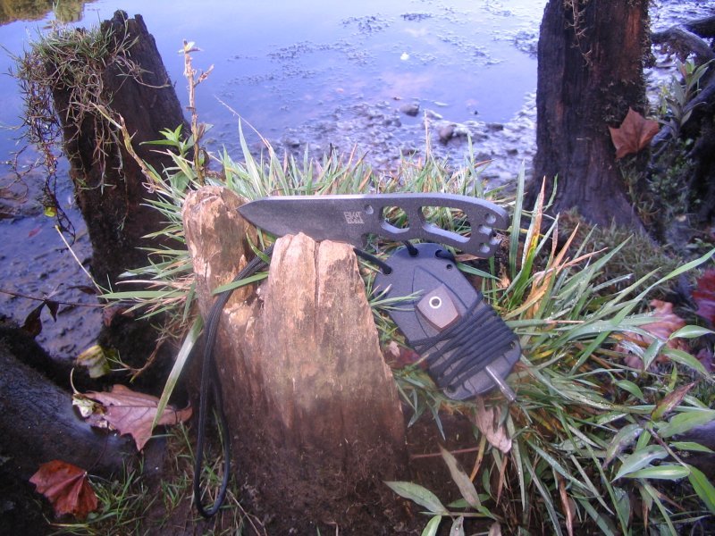

In other news... more Becker content. I was recently given a BK11 (thanks Ethan and KA-BAR! :) ) and of course, I modded it some. This is such a well-designed blade that it only took moments to tweak it... all I did was clean up the factory edge and knock the powder-coat off the spine and polish it up so I have crisper corners with which to scrape sparks off a ferro-rod.
The black cordage shown in that pic comes with the knife/sheath, and there's plenty of it. I very strongly recommend not tying it in a knot if you hang this knife around your neck... simply heat up both ends with a lighter or candle, mush them together, and let it cool off. That way if something really awful happens, you won't get strangled, the melted "joint" will break.
