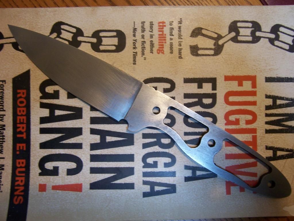

Just went down and drilled the holes for the handle pins and lanyard tube. Then smoothed out the ridges by hand with sandpaper and made sure the handle pins will fit snugly.
All ready to go the HT now.
Them scales are looking great bud!!
A file will do that too.
got 'em countersunk? that's important.
Why is that important for holes you want pins in? I read NOT to countersink holes you want pins in??? Could make the pins not fit snugly at the very least give them less to attach to?
I got them de-burred pretty good though.
Edit, well im reading to countersink and not to countersink now. I thought countersinking was done mostly for aesthetics. I can understanding removing the burr but is there other reasons for countersinking?
I just figured the steel is only 1/8" countersinking would remove a little around the hole on both sides, that doesnt leave much for the pin to attach to. But i guess the pins are really to hold the 2 scales together?
Just trying to understand WHY things are done instead of just simply doing them because i read to do them.
Thanks for the advice bud!
Always countersink, from what I've been told. A few reasons. First, those sharp edges can cause stress risers during heat treat, from what I understand. Second, the pins are mainly for preventing movement along the axis of the blade. Most of the work relative to holding the handle scales on is done by the epoxy. Countersinking gives more space for the epoxy to grab a hold of the pins. In fact, you don't even want the pins to be exactly the same size as the holes. It's harder to fit, and won't result in as positive a fit, because you need space for the epoxy all along the pins so that they don't come out. There's a few more reasons, but those were sufficient for me.
Thanks for the info Crimson!
I went ahead and countersunk them, funny thing afterwards the pins didnt fit the holes... Its like the countersink bit tightened the hole or something... Easy fix just using the drill bit to clear the holes again.
It seems people do things different when it comes to what sized holes to drill in relation to the pin size. I find people saying to drill the same sized holes and people saying to drill them a bit larger. I went ahead and drilled both 1/8" and 9/64" just in case. All holes are countersunk as well. And the handle sanded a bit to remove any top ridges.
Not sure if there is an issue with my countersink bit or what but i found it funny that it put a small ridge or lip on top of the holes and made the pin not fit in the holes. It seems opening the outside diameter of the holes would make it fit better, not worse. Is this normal of a countersink bit, or maybe mine is dull or something?
What he said.
yes, the countersink can raise a burr both on the surface and inside the hole. Soft metal squishes around under pressure. You might try less pressure, but I haven't experimented a lot with it. You solved the problem the usual way. Good to go.
What he said.
Good to know!! I was a little worried my bit was jacked up LOL
Is it possible you made a tiny burr inside the hole? That could cause the hole to tighten up.
Anything is possible but the holes looked clean still, I couldnt see any burr at all except on the surface. What Daizee said makes sense now about the soft steel squishing.
