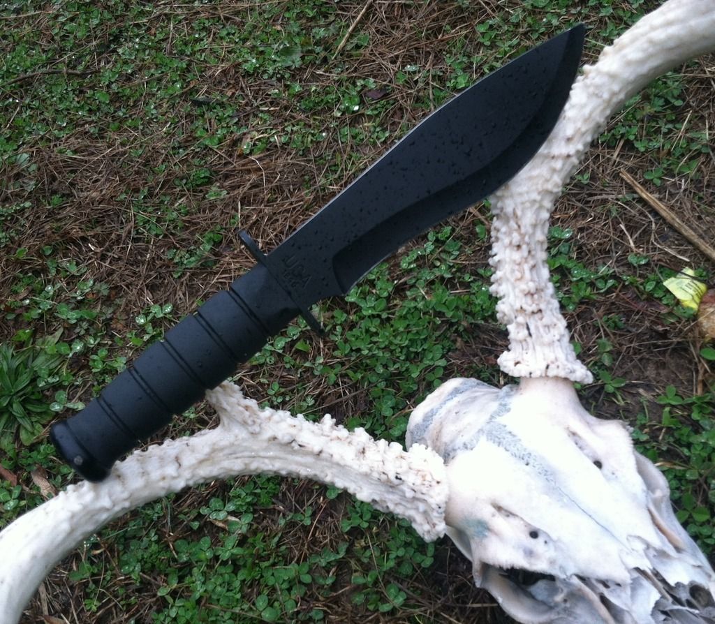

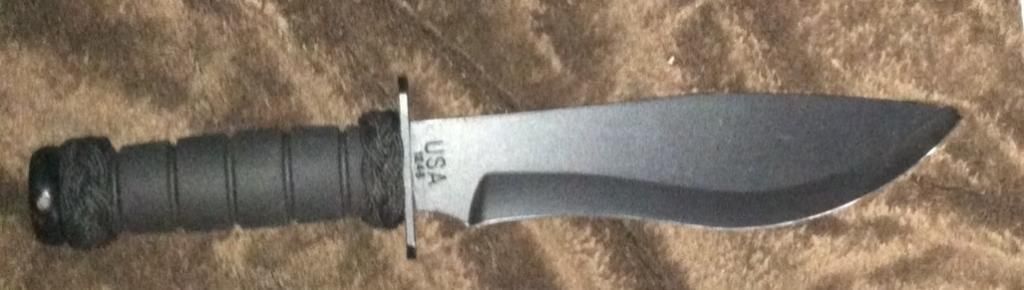

Well at the behest of our own GSOM here is a little KA-BAR 1211 mod I knocked out yesterday. When getting pics together I realized I have probably modded this knife a little bit by bit since it came into my possession years ago. So I grabbed some similar pics to show the progression.
When I first got it, it was just beat up KA-BAR with no edge, and some chewed up blade coating. A lot of the edge had been eaten up already, so I sharpened it up, stripped it, then gave it a hot vinegar bath.
After that it was just put to use, over time the edge just became more and more convexed... Also sometime around here I sharpened the clip on it for giggles, didnt like it much so I knocked it off which exaggerated the clip some.
Finally it got to the point it was looking pretty rough, so I gave it a little spa treatment. This included a hand done regrind. Basically reground the bevel on a course then medium stone, then gave it a little hand stropping. This helped with the thick grind/edge a lot and made it such a better cutter but after some use I thought it could be better.
SO just the other day I took it to my 2X42 and thinned this sucker out a lot. Brought the grind up probably 1/8" or so... much slicier... Also exaggerated the clip some more on it.
Well speaking to Hoss over in the snark thread I decided to go ahead and mod the guard. Like it a lot this way. Also stripped the paint off the of pommel and guard then hit everything up with a wire wheel. Gave it a quick buff and I think its ready to go!
Who knows what will happen to this knife over the next couple years. :D
Added an older pic, then a current one to better show the difference.
