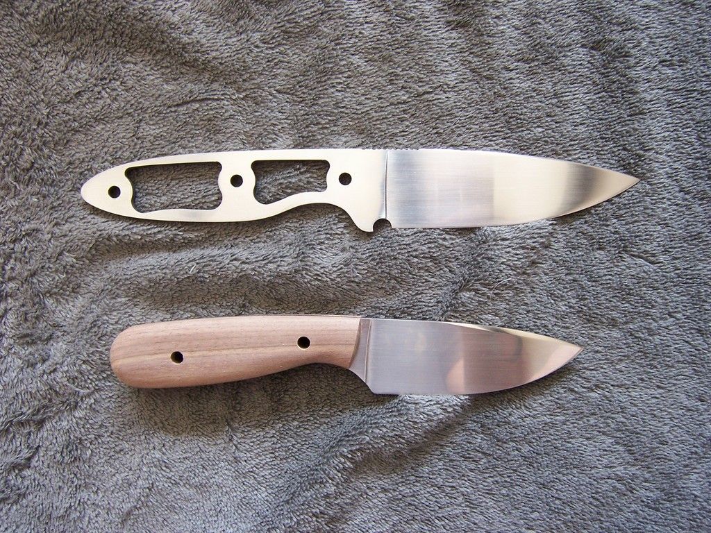

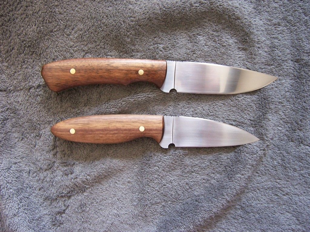

These BK 16 customs are complete...Finally! I am still working on the third BK16 and the scales for the BK14.
