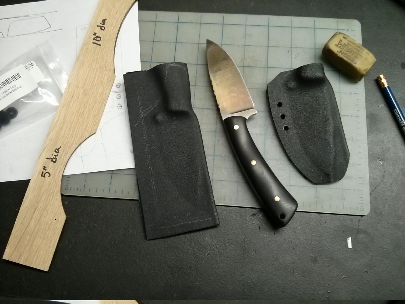

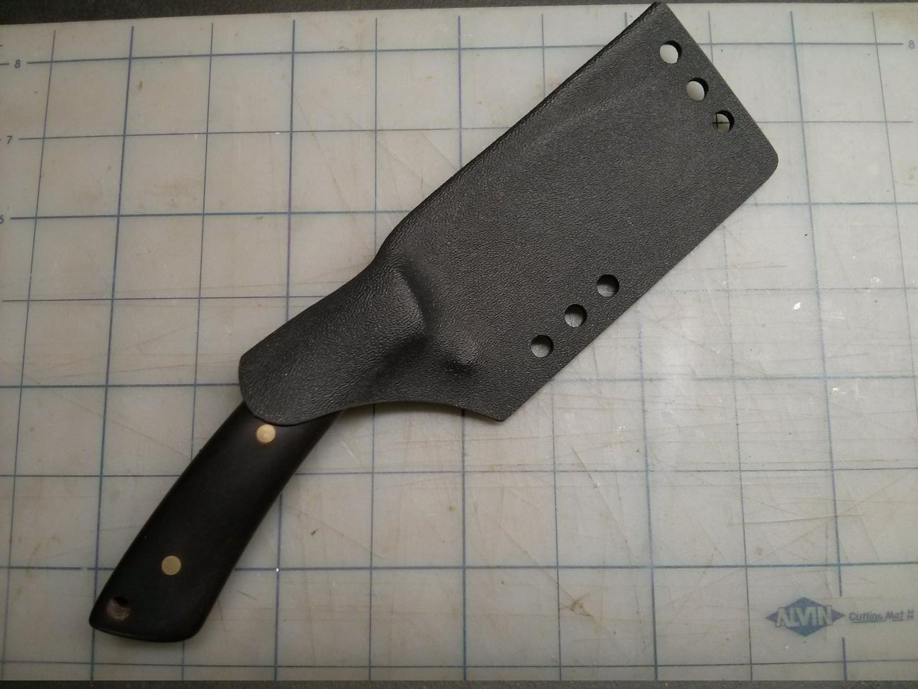

This early Mountain Knife (mine) had a crude sheath from before I settled into my style. It was time to make a new mini-bushcraft for it:

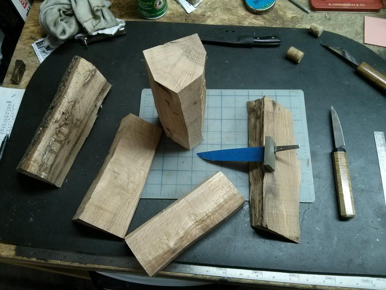

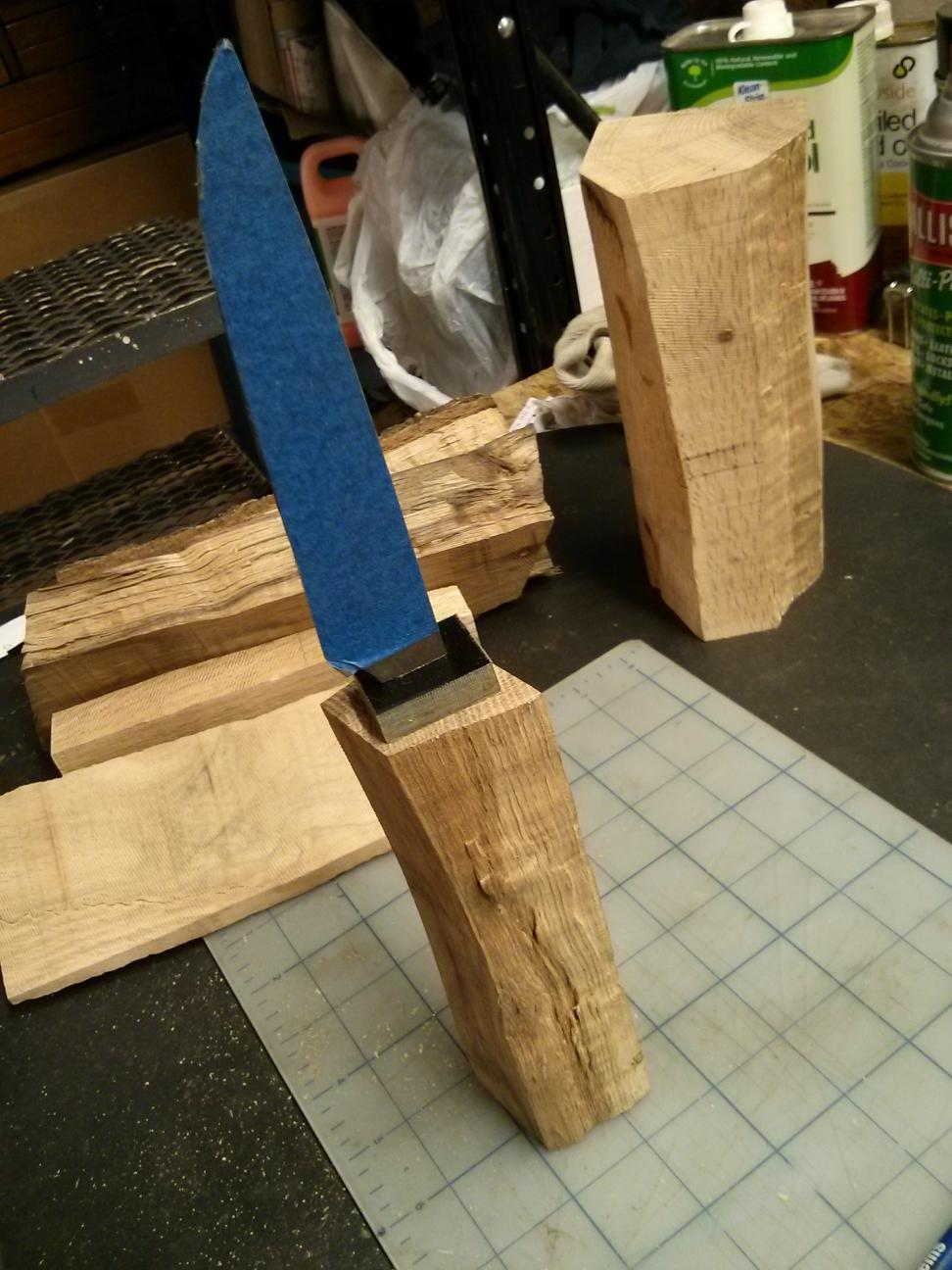

Selecting wood for a handle, then fitting:

I love the look of your handles Daiz, that Mountain Knife looks like it just plain kicks booty. Plus that sheath turned out nice. I am really starting to dig the square bottomed sheaths. I really wish I could get out into the garage more but school is keeping my head firmly underwater. The knife I'm still working on is in A2 solely because of your recommendation many snarks ago! I have a pile of designs, templates, and steel, just no commitable time!

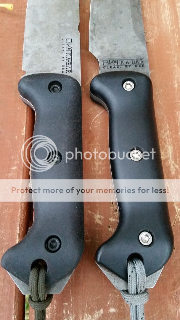

Okay ladies and jelly spoons, did some more work for my BK2 mod today, its been a long process but I wanted to do a bit of experimentation with the stock grivory scales using a process I have not seen done before with the scales... Stonewashing! Forgive the photography its fairly slapdash this time around. I made this a project for kiddos and I...
First things first I scrubbed the scales with 500 grit wet and dry just to give them a glazed up look and sort of "level the playing field" so to speak. Then I laid the tang side out with some blue painters tape and cut around the scales. I did this to mitigate any edge damage that might occur to the scales, I dont think it helped too much, I would probably recommend duct tape. Next I found a old coffee can/jug/container thing, and went outside with the kiddos. We are in the processes of demolishing an old BBQ pit in the backyard so for the stones for the stonewashing I used pieces of concrete and broken bricks. Me and the kiddos dug around and hunted for the perfect ones. Next I threw the scales in, covered them in the rock and went to town shaking it up... or shaking it off and T Swift says :D
Just to kinda check for a baseline of the "damage" here is just after less than a minute of shaking it off, or up... whatever. Made a heck of a noise which the kids thought was hilarious and we also took turns throughout the process. Here they are washed up after the short little shimmy shimmy.

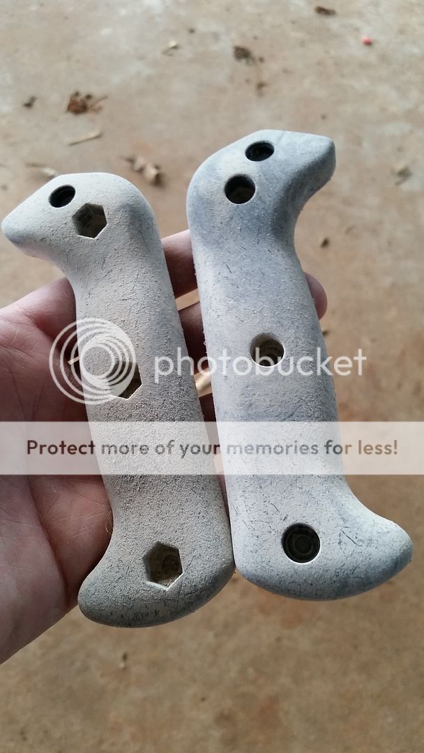

Threw them back in the can and then gave them a good couple minutes of shaking and baking. This is what they look like coming straight out of the rocks... covered in dust. Actually kind of neato looking.

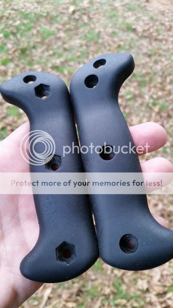

and here they are after washing them up with soap and a scrub brush...
Some close ups of the damage... like they have been living on a gravel country road for a couple years ;)
To finish these up I went ahead and hit them up with a little bit of fire, and then gave them a rub down with some beeswax. I then wiped off any excess until they were dry.
The end result is pretty cool. They are roughed up, but they still feel soft, almost like hard rubber not abrasive just frosty not quite tacky. I have stippled scales before and did not end up liking it all that much, this adds grip without the roughness. I also took some "loupe" shots to get some close ups of the texture.
I got closer but I think you get the idea ;)
Here is a comparison between my BK5's stock scales. Next time I am at the hardware store I am picking up stainless hardware for the BK2, but I may do something a bit different, dunno yet.
There is a big difference here in traction. I am not huge on needing traction on scales, but I am modding this BK2 out as a "kit" knife so I figured some extra grip would not hurt. Plus people are always looking for ways to improve grip on the Becker scales, so I wanted to make/try something that was cheap (uhhh free?) easy, and effective. Plus its an option that doesnt destroy the ergos of the handle or provide so much grip that it ends up being abrasive. I want to experiment with this more with some different materials like micarta/zytel etc. Also it might be cool to stonewash it, paint it, and then stonewash again for a sort of distressed look.
And here it is sans sheath. FYI regrinding the 2 was the best thing I have done for it... it cuts like a mora with its BK2 backbone. I have also battoned it with this geometry through knots with no edge damage. The geometry is really stable and cuts so well.

Thanks! And as I put in the op, one of my "intents" was to make a way for anyone to add "gription" to their scales that was cheap, easy, and effective. Just takes the tiniest bit of elbow grease.
I have played around with stipling including different ways of toning it up or down, rubberizing, and all that, for a user blade that is in your bare hands constantly, it just doesn't work out for me. However, for a knife that would be used on a boat, over or underwater, or in super greasy environments it might be beneficial. For woods work or general work though, ergonomics and smoothness win every time for me. This mod though adds some grip without adding unnecessary "roughness" it's a smooth/soft/warm texture. To chop well with this knife I use a 2-3 finger grip holding onto the butt, this gription will just make that a more secure endeavor.
Also as a side note I would recommend using trimmed up gorilla/duct tape to protect the edges of the scales. Different rocks will probably produce different effects, you can buy tumbling media, or just walk outside ;) think sharp and abrasive. I would also recommend shaking for a short time (30 seconds or so) then checking your progress, (it's plastic and doesn't take much) then repeating until you find your desired level of damage. And above all else.
