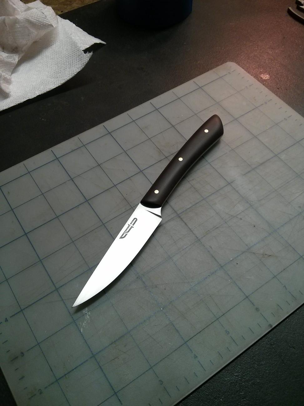

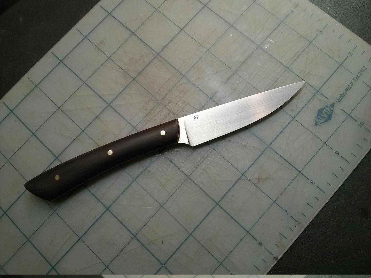

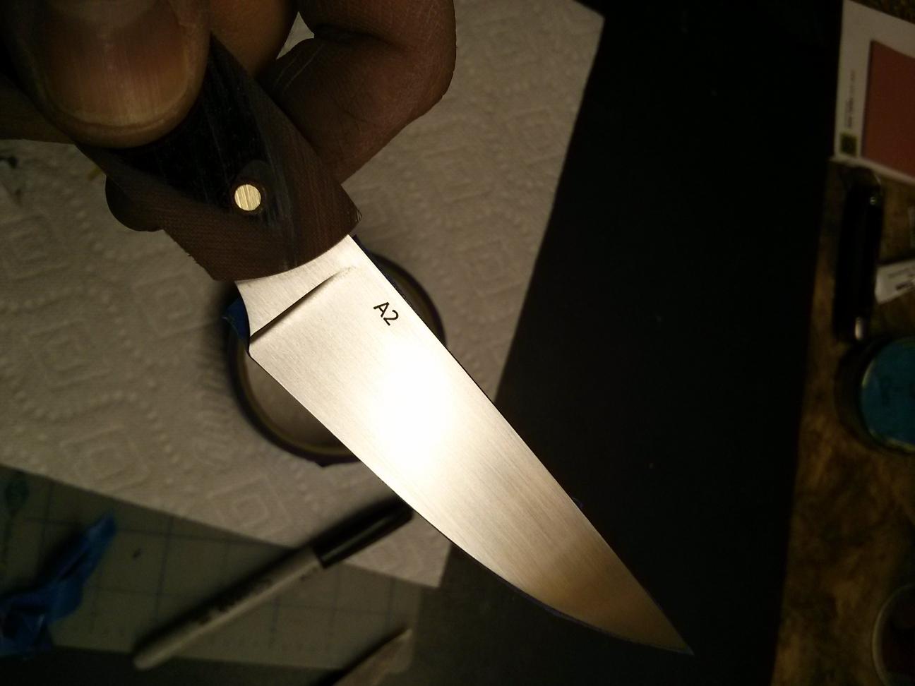

All this talk about grinders....I still need to replace the table on my 2x42 (I bent it when I fell on the grinder and knocked it onto the concrete floor) but the rest of it is useful. Finally finished up my little 16 project. Re-profiled the blade a little, crowned the spine a little, added a firesteel notch (crowned spine doesn't strike the steel too well :rolleyes: ), put in subtle yellow cutting board liners and rounded off the sharp edges of the KB Micarta. Finished of the Micarta with some natural Danish oil and power buffed it with carnauba wax. After I was done re-grinding the blade shape, I also took it to the slack belt to redo the edge and thin it out a bit. Pretty happy with how it turned out; now Imma gonna hafta make a sheath for it. Oh, yeah - took the blade to a 600 grit semi-polish. Made it hard to take pics...
POIDH!
Gonna hafta break out the new Christmas DSLR for pics, this one's a little blurry from the phone...
Lost about a ¼" of blade length dropping the point a bit, but so far it cuts great on cardboard and my scrapwood test stick.
