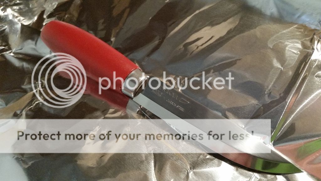

Well for christmas this year I received a Mora Classic #2. I honestly really like the knife but it just felt like it had some potential. Plus since it was a gift I decided to make it a bit "nicer" more unique.
Started with just a standard Mora, nothing fancy, here it is sitting waiting for chemicals...
First thing I did was clean up and straighten up the spine, the carbon moras come with rough spines, up to 1200 grit and then hand buffed with compound. Then I applied stripper and began taking off the paint. For some reason this paint decided to be a pain so I ended up sanding off a lot with 60 grit, plus the grain had soaked up a lot of red giving it a pink look. Once it was bare and clean I took the time to reshape/clean up and straighten up the handle. Then I flattened the butt to prep it for the next part, adding a butt plate.
Decided to due this just because I figured it would turn out looking neato. Used some G10, Aluminum and 3/16 brass rod. I drilled a hole in the butt of the knife to accept a pin. Also had to end up drilling hidden epoxy pin holes inside the aluminum, g10, and wood due to the an issue that occured after attaching it the first time. The epoxy set up, but ended up having a failure with the aluminum the first time around. So I re-thought and re-worked it! The through pin is tiny, but it has a groove ground it to hold it in the handle, and then it's been peened against the aluminum.
After reshaping everything I toiled over how to finish the wood, but after conversing with the brain trust (my 5 and 3 year old kiddos) we decided to shoot for a red stain similar to the red paint as a kind of call back to the classic coloration. Used bright a red rit dye method as the hardware store was lacking the color that suited my daughter and son. Stained it a few times buffing up from 500 to 1000 all the way up to 0000 steel wool. After I got it close to the final shade I finish buffed it with my beeswax concoction. Hand buffed the pommel/butt plate, and fittings, then re-buffed the blade. The intention was making something that looked like a fancier version of the same knife, I really like it, plus now it's my own.
