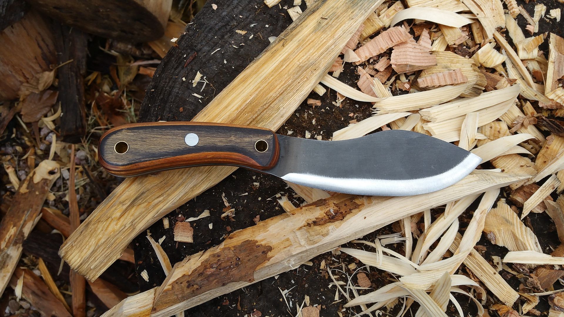

Good looking 16 GSOM! To anneal the new handle area of the old machete blade I just used a MAPP and propane torch together to heat until cherry red and then let cool on its own. I used the vice as a heat sink to control how far the heat went.
Well after using it for a bit I had to make some changes to it. I changed the handle/grind transition area to be swoopier and changed the grind closer to the handle since I left the original blade shape. Then I dropped the point an inch to get the point in line with the handle. This is how it will stay now. I am calling this one finished.![]()

Love that blade, great job Sir !!!Well after using it for a bit I had to make some changes to it. I changed the handle/grind transition area to be swoopier and changed the grind closer to the handle since I left the original blade shape. Then I dropped the point an inch to get the point in line with the handle. This is how it will stay now. I am calling this one finished.![]()
Looks good! tobiism, if you're gonna shuck out that kind of money, I'd save up a bit more for a variable speed setup. I think there's a guy on here who makes some sweet grinders in a similar price range. I think I paid about the same price for mine, and got variable speed, although it would have been nice to get an enclosure for my controller.
