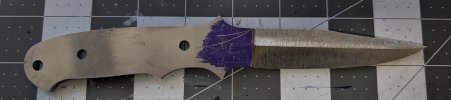

The bevels are very complicated and challenging for me. I managed to complete the rough grind without any mishaps.

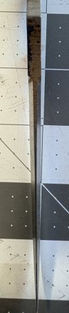

Like any dagger, you need to line up 4 plunges. However, on this one the bevel at the top is only sharp past the break in the spine. From the plunge to the break it's supposed to slowly taper.
(This is shown in the second picture)
The bottom bevel forms a sharp edge right from the plunge. All the bevels are deep hollows, but it's not a straight channel, there's quite a bit of finesse towards the tip. I've got all the edges that will be sharp to 20 thou, so once I taper the tangs it's off for heat treatment.
