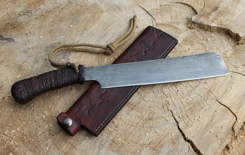

Here is the blade geometry on a comp style chopper I've been playing with. It is a little over 3/8 thick at the spine and has a full blended convex grind with about .015-.020" behind the edge bevel. The blade is 11"x 2"x16.5 OAL and 39 OZ's of 80CRV2.
image by waterstoneblades, on Flickr

That blade looks completely different from the others I've seen in this thread. Wouldn't the thin tip work against you in competition?
It's a lovely blade, and I don't know much about competition cutting so my confusion is probably my own fault.
Edit: I misunderstood the angle of the photo, that's a cross-section view of the blade isn't it?
Yes, sorry I wasn't clear on the picture. The blade was positioned upright looking down on the nose when I took this image.
