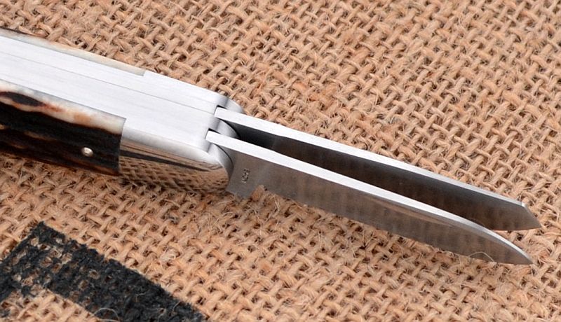

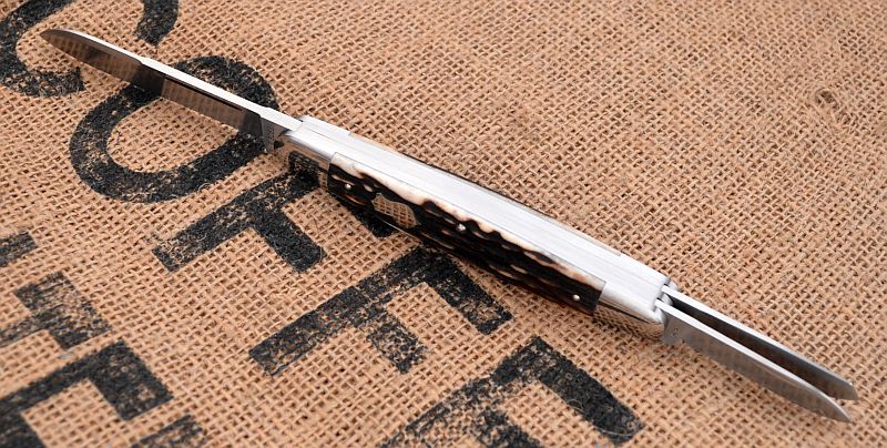

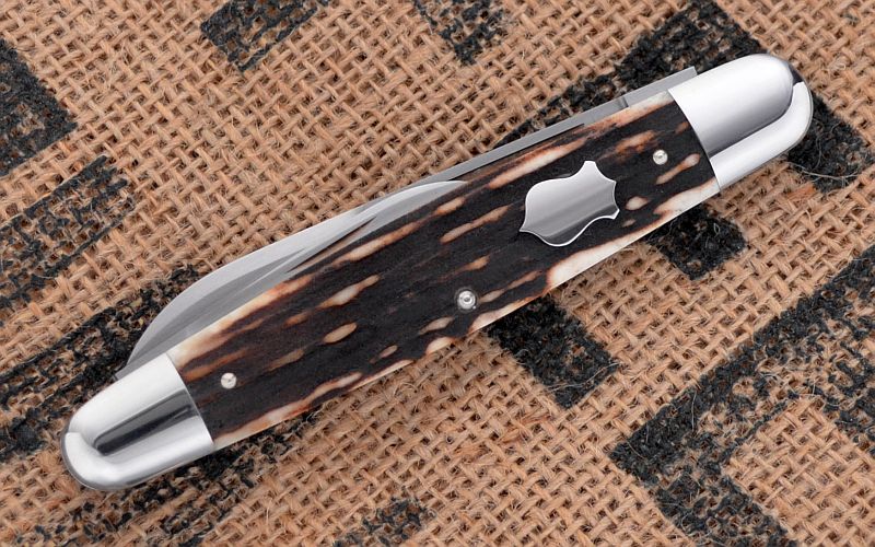

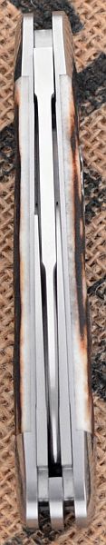

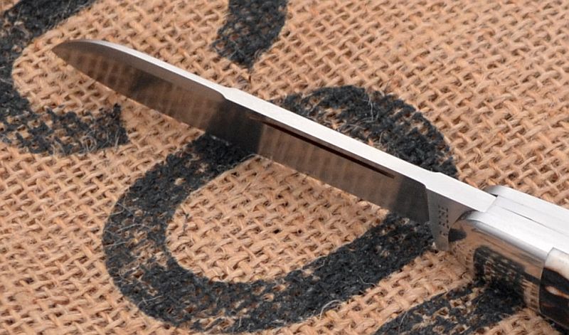

I wish everyone could have the opportunity to try and PROPERLY fit stag to a knife with bolsters on both ends. We look at these things and have lots of adjectives to describe how great they look but have no idea how difficult it is to make that happen. Tony and Reese makes it look soooo easy and do it time and time again. This Anglo-Saxon Whittler covered in stag by Reese is a perfect example of properly selected and fitted stag. Oh and...yeah, the rest of the knife is pretty dang good too. :thumbup::D
Gorgeous, perfectly matched stag, and those big round bolsters are just magnificent!
Truly awesome. Thanks, as always, Kerry.
