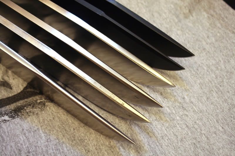

Actually the tips are not thick like a tanto and actually the SHBM has a better profile for cutting that a mora and most small knives because it is 1.9" wide:
You didn't answer my question at all with regards to how the test is actually done but I do appreciate the pic of the SHBMs... :thumbup:

I will totally agree with the steep edge angles. But I have tips on my busses that are thinner than much of the competition. The blade profiles on most are thinner than the competition as well. The geometry of a 1/4" thick flat ground blade that is 1.9" wide is actually pretty thin.
Yes, that is definitely true and those old school Straight Handle Battle Mistresses are sweet knives.
I may need to get one of those... :thumbup:;):cool:
They come up every so often. They are solid. All of my videos above are those old school SHBM's.
