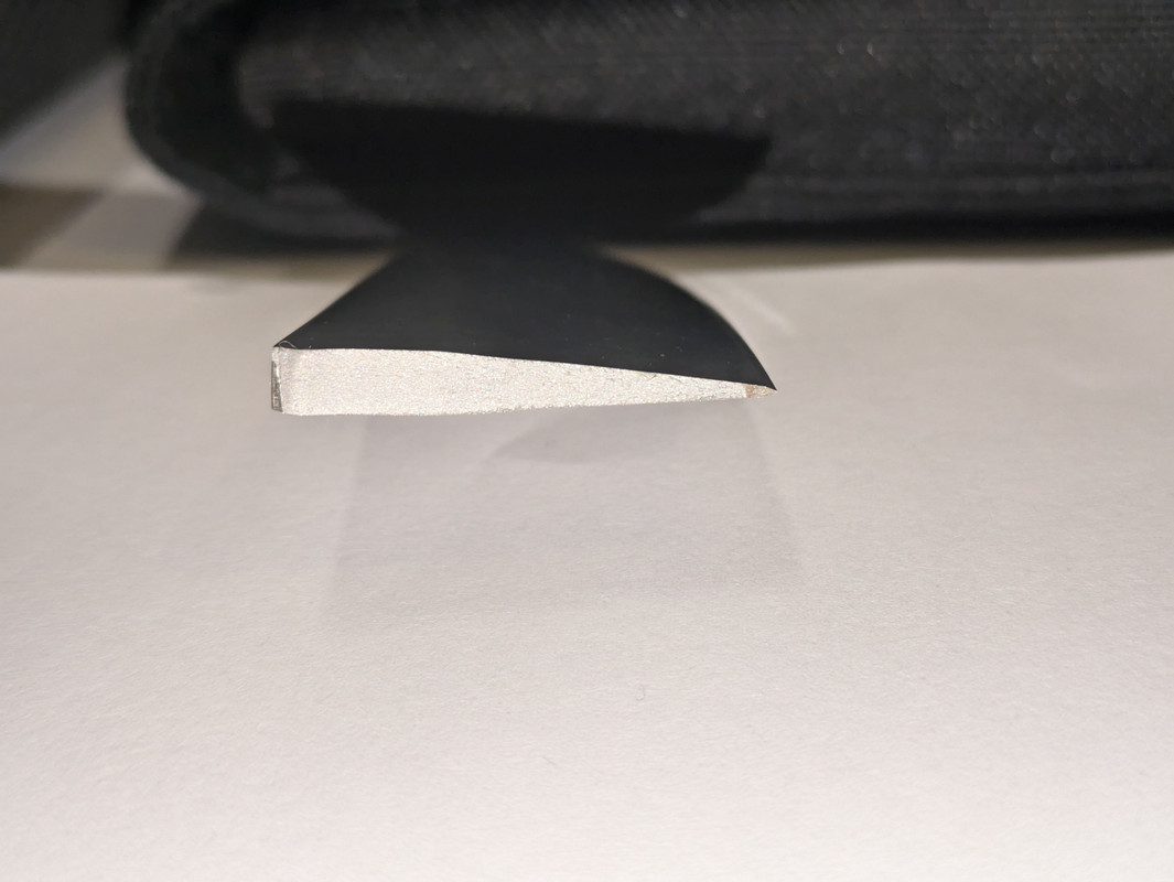

i done nearly the same as Spyderco911 :-) I broke an Knife with D2 Steel while doing batoning and have a question.. no not "why are the hell are you hitting a knive with an stick or hammer?" (i have an answer but here could be children online and they should not read it ;-) )
the knive brokes at the first jimping
On the breaking edge of me knife looks the steel strange for me. it looks for me, as a complete steel noob, like that the tip of the knife was burned out
It was an knive out of the small badge production run from russia (a lot of years ago produced)

That discoloration on the edge break could mean there was a crack there for a while before it broke.
Additionally, to me, that grain structure doesn't look very good at all.
Thanks for your assessment. That was my assessment too, but I'm a complete steel noob, so I wanted to ask.
Then I'm glad that the knife broke when I didn't need it and I didn't hurt myself.

Not to split hairs, but any discontinuity, no matter how small, can concentrate stress (and strain), leading to failure.
On a 2" diameter prop shaft on a boat, you could have nothing more than a graphite pencil line left on the monel prop shaft, but because graphite is more cathodic than anything else in the galvanic series, it'll eventually cause a microscopic line of corrosion there = stress riser that with repetitive strain (bending/vibration) will eventually cause microcracking, and once you have a crack, even if microscopic, it's all over, because cracks grow with fatigue. It's just a matter of time. Even in a 2" diameter prop shaft.
Yeah, jimping that has radii machined at the bottom of the grooves will focus stress (and strain) less than jimping with "v" shaped bottoms...but they're still stress risers.
In the context of a knife, a finger choil of appr. 1" with properly chamfered edges etc. is not much of a stress riser in practice; though perhaps mathematically in theory. A narrow V-groove, repeated tenfold - aka jimping - is. And that is what I stated.
You should read the whole thread (skip the banter). You will see I discussed surface defects, crack formation and crack propagation.
In the meantime, you and anyone else still reading, may want to study the 3,000 odd pages of Physical Metallurgy, co-edited by one of my thesis advisors, the late, great Peter Haasen.
