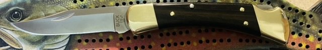

I wouldn't be surprised based on this comment from their Instagram. I'm betting for a 110 with magnacut blade and jigged micarta handles (to test out jigging the micarta for the barehead 110 supposedly coming this year)
Based on absolutely no evidence, I think it'll be a four blade camp knife with a bail and micarta handles, but I'd settle for valox.
Bummer, no interwebs at house so missed this one, looks like a great blade, really interested in hearing about how it performs and how difficult/easy it is to sharpen.
The actual Rockwell averaged 61-62. We choose the lower Rockwell on this project due to the toughness loss at the higher hardness. For our product customers, it makes more sense. The tip breaking on the 110s is one of our top returns and we know people pry with our blades (gasp! lol), so we wanted the toughness. Plus it is easier to re-sharpen etc.
We have just adopted a new sharpening method that has raised our CATRA scores significantly for initial sharpness/total life, so edge life should still be there at the lower Hardness.
Hope this helps.
Jeff
Mine was definitely very sharp out of the box!
