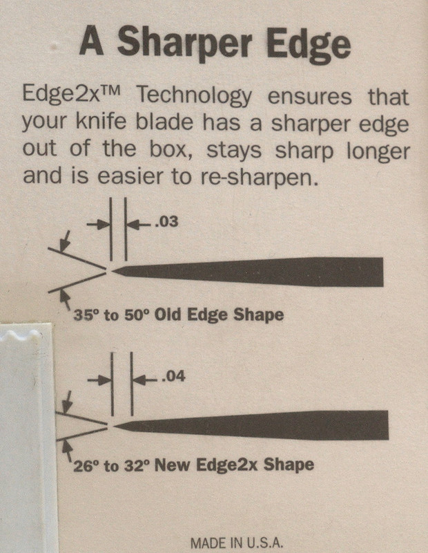

Back in 1999 Buck introduced Edge 2000, also known as Edge2x™, where the final edge angle was reduced from 17.5 -25 degrees, to 13-16 degrees per side. At the time they stated this, “Technology ensures the knife has a sharper edge out of the box, stays sharp longer and is easier to re-sharpen.”
Is this year's new sharpening method for all knives or just Magnacut? How have they achieved higher CATRA scores? Lowering the angles more, changing the hollow grind geometry, wet grinding to reduce burnt edges, adding a micro bevel, or...?

I’m not sure but from the way Jeff stated it that they are using a new sharpening method. He didn’t elaborate on it but I think the edge is still sharpened to the same angle just done in a new method. I don’t know maybe they are using some kind of guide system for better accuracy and consistency.
