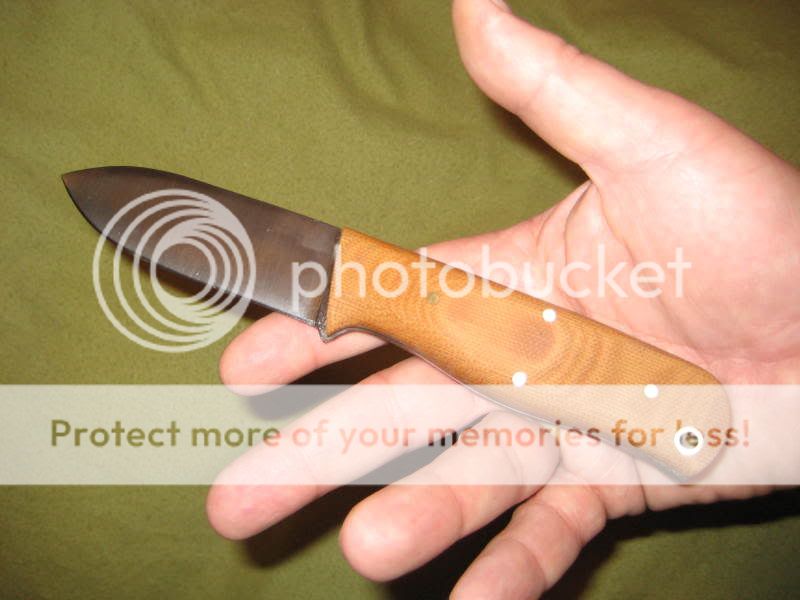

I was fortunate enough to score one of these bushcraft knives from Walter Davis and it finally arrived today :cool:. This knife was scary sharp out of the box and might already be my favorite :D I hope to get out and put it to the test soon. Walt's craftsmanship is top-notch and I hope this passaround gives him the recognition he deserves.

I did some playing with the knives today. There has been some great constructive feedback on them already. I mostly used the smaller knife because I liked the slightly fatter handle better, though I thought both knives were comfortable.
I did a little batonning, the thin blade stock slid through easily
Cut some notches
Was able to easily get some paper thin curls with it, the edge geometry is great
I have an broken hickory axe handle, this thing is hard as a rock, but I was able to get some little curlies going
I really like the sloped portion of the handle near the blade. It's a comfortabe and secure spot for my thumb when slicing in a reverse grip
So far I have used the knife for a few hours cutting different things and I really enjoyed using it. Handles are a pet peeve of mine, and Walt's are done right. they are well rounded on the corners and are nice and hand filling without feeling blocky.
The only thing I would change on this knife is I think the point is a bit too thin. If I were to order one, and I most likely will, I would ask Walt for slightly thicker stock and to leave more metal out to the tip. It's just personal preference for me, but I would love this thing in 5/32" Though it performed perfectly in 1/8th thickness. With a couple sheath improvements that Tal has pointed out, the whole package would be perfect. Walt's prices are a great value, so I will have to grab one of these before his prices go up!
