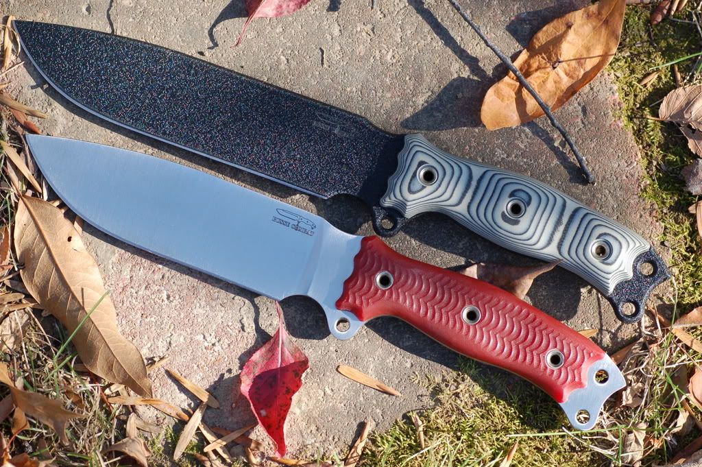

do not get me wrong, I am not trying to claim it wasn't a GW, just that the blade looks considerably less wide than normal, which leads me to believe that if it is indeed a GW it has been heavily modded. If that primary bevel is as big as it looks and from the width of the blade it is, then those deformations are almost not visible to the naked eye.
Hmm. Very good point, but then you always have a better 'eye' for this than I do.
The further the knife departs from the maker's design, the more un-representative it becomes. But ... quite possibly a better slicer. :)
This is Busse Game Warden and I sharpen it to 30 degree. Original edge was I guess about 50 degree or something and very thick. Edge looks so wide because it was initially very thick and when I brings it to 30 degree it became wide, also I usually "convexing" edge shoulders it also add some width.
This is not reprofiled or any other way modified Busse, I just sharpen it to 30 degree. All Busses usually has very thick edge with big angle out of factory and after sharpening them to my standard degree - 30 for all knives, edge always looks thick.
And I use DMT for all this Busses - no any power tool (after I got D8XX).
Thanks, Vassili.
This is my Busse collection, just to show that I know what I am talking about. You may see all of them has wide edge and all 30 degree.

I beg to differ. There is almost no ricasso left on that GW. The width of the blade is not what it was as you have taken off at least 1/8 to 3/16 of an inch in width. I call that reprofiled. Sorry. I have had edge work done on mine, and no one has gone that far. also how does a 1/4 inch of bevel on each side equate to 30 degrees? I have blades with less bevel that are 28-30 degrees. To me that looks closer to 20 degrees.
I beg to differ. There is almost no ricasso left on that GW. The width of the blade is not what it was as you have taken off at least 1/8 to 3/16 of an inch in width. [/B]
Actually, the width of the blade (or I guess I could say the height of the flat side of the blade) doesn't look off to me. I have a black/black Game Warden .200" that seems to have the same kind of blade width. Some Game Wardens seem to come out of the factory not quite so wide of blade as others. I have other GWs, like my urban / tan that is so much wider that it is easy to tell by naked eye without even having both knives out. But, as I've said before, there are large variations in the measurements of Busse knives. Thickness, width, even length seems to vary quite a lot from the official specifications - although the latter varies the least of those three.
That said, the edge on Nozh's GW looks way off to me.
could be. I don't have all of them, but the ones I have have more prominent ricasso. Also, the 30 degree angle may be correct depending on the thickness of that blade. If that is a fatty, then it is logical. Regardless, as my post above indicates, there is no comparison.
