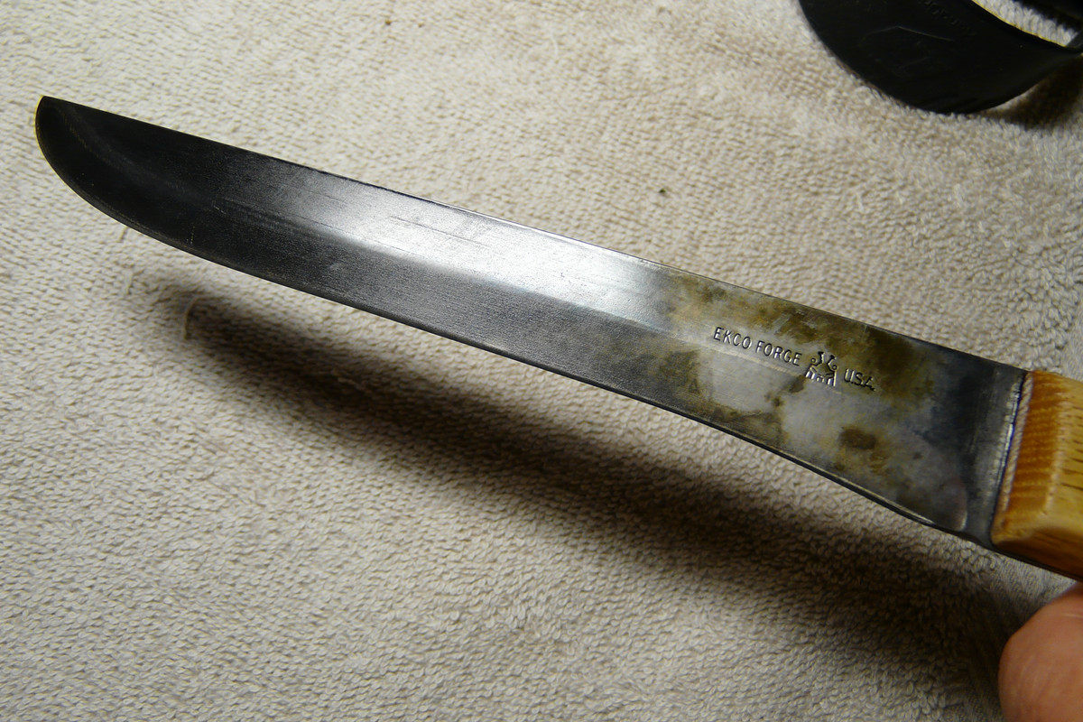

I don't even try on the freshly polished , but after 40+ years of cutting pineapple , the truth is revealed , TA-TAH ! :
