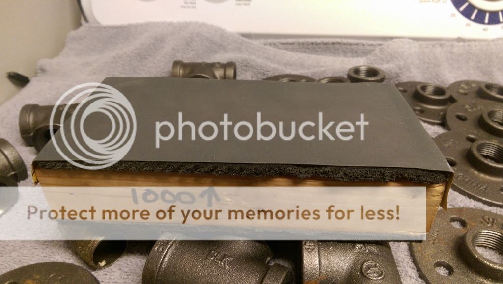

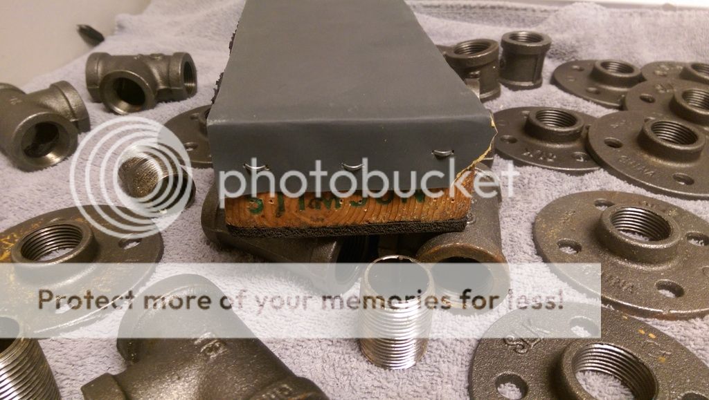

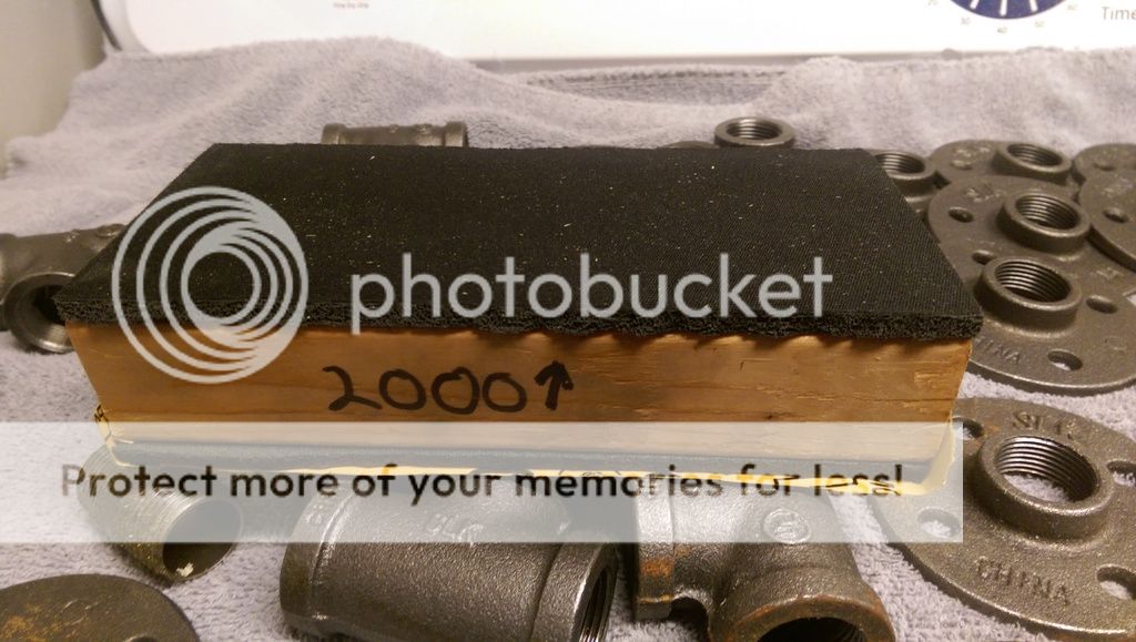

This last summer I started convexing the edges of some of my knives. I was surprised at how easy it is to get a very sharp edge. I just took a chunk of 2x4, cut up the thickest mouse pad I could find and glued a piece to each side of the 2x4, and stapled some sandpaper over the mousepad. I used 1000 grit on one side and 2000 on the other. Very effective, very cheap, and super simple to replace the sandpaper when it's used up. Just pop a couple staples and staple a new piece on.
I've found that with this method I don't have to be near as precise with keeping a steady angle.

Can you post some pictures

You'll have to forgive the quick and dirty pictures, but I did my best for 2AM on a Tuesday night. I popped the paper off of one side so that you can see it a little more clearly.
As you can see I wasn't too particular when I was putting the thing together. I mostly stay to the middle, so the fact that the paper and mousepad hang over the edges a little doesn't really bother anything. I slapped the thing together in a couple of minutes figuring that I wouldn't use it more than once or twice, but it's now my go to sharpening system. Once you get the convex established it just takes a couple passes on each side of this and it's ready to strop.

I definitely recommend it. I don't sharpen all of my knives on this, but a good amount of them. I'm switching more and more over to convex as time passes. It's also about a two minute and three dollar investment, so there's not much to lose. ;)
