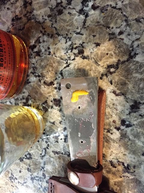

Can someone with a D2 blade run a patina test? It should be fairly difficult, but not impossible to get a mustard patina on the steel.
Without an analyzer it's impossible to know the alloy for sure, but the first thing I'd do is compare the corrosion resistance to another knife I have in D2.
These are all D2. I'll do it if you give me some instructions. I assume I can run the test on a spine and buff it out if it takes?
I can just do it on the butt end of the red handled bowie or remove the handles and do a big section of the flat.
You should be able to buff it, but please don't do it if you are uncomfortable with the possibility of a permanent mark, or even light pitting. Unlikely, but possible.
Do you have a knife that is known (for sure) to be d2?
If it were mine I'd apply mustard to an area and let it dry. You should have some discoloration when the mustard is cleaned off. Doing it side by side with a known blade in d2 should be useful.
If mustard didn't work I'd try vinegar dabbed on with a paper towel. It may need repeated since it dries quickly.
If you get no results it doesn't mean that it isn't d2 necessarily, but I'd be very suspicious in any case.

That's it? Just plain French's Mustard until it dries? no time limit? Once I get an answer I'll do it on this one. In the interim, it lights a firesteel up nicely though:
It's not an exact science, you can do it 100 ways. The only thing it would show is that it is or isn't stainless. An experienced person could probably tell by the results if it has a high percentage of chromium as well just going by the difficulty in obtaining a patina.

I'll give the test a shot. I'll try mustard and some vinegar/salt if I remove the handles.

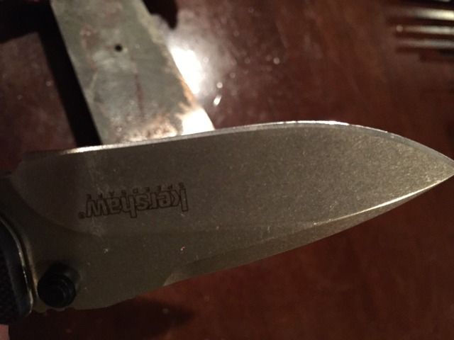

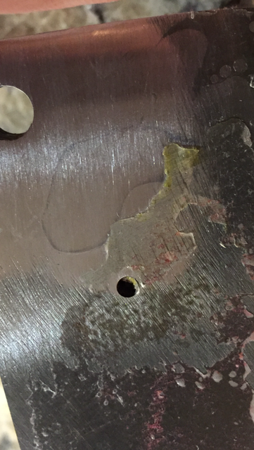

FWIW, here's what I got using mustard and salt for 30 minutes:
A grey outline of the mustard but I think it needed salt to discolor it. For the record, I am not claiming anything about CFK knives or steel. I'd like to get the actual facts like everyone else. Like I posted I personally think they are Pakistani. I also think if there was no BS surrounding the origins, they would be decent bargain blades. I haven't beat on mine yet to really test... I did knick up and roll the edge on a G10 Cryo prying the Scale off this one though :) They are glued on pretty well. I guess I should have used an old Presidio ;)

I did it on my be CFK D2 knife. I rubbed the mustard on, let it dry on (about 45 min) then washed it off with cold water. I got a slight discoloration. It almost has a "nickel" effect. But it is very feint. I tried taking a pic with my phone but it doesn't come out really good in the pic. Should I leave it on longer to get a better effect?
