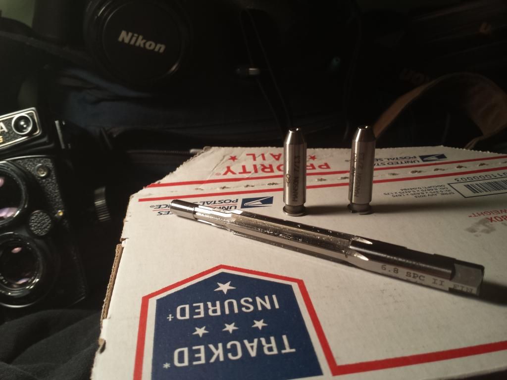

Got more gun tools on the way, rented a reamer and some guages, gonna change the chamber in the barrel. Lengthen the free bore and change the leade angle to help keep pressures down and allow me to run hotter loads and heavier bullets. Should be just what's needed to get out to 800 yards on an 8" kill zone (basically just under 1 MOA).
Been a long time since I have built a brand new gun from scratch, I've typically rebuilt older guns. Having fun with this project for sure!

Xander that sounds cool, is the reamer a boring machine of sorts or a really huge chucking reamer? Maybe we can collab on a shoot and cut... :D AR15/Framlock

Just a reamer. Usually used in a lathe but since I'm changing an already finished chamber I'm using what's known as a finish reamer basically in a tap handle. Floating pilot for self centering (and not damaging the lands) as well. Got some head space guages to make sure I don't screw things by going too far, lol! I considered buying one but $140 for the reamer, $20 for some pilots, $60 for guages, $40 for handle, and $200 for micrometer adjust stop I would have to redo lots of chambers to justify it. That's only for one cartridge spec too. There are often multiple specs for the same cartridge. I'm building my gun in 6.8spc, but my chamber is in the original spec'd dimensions which had a short free bore and too steep of leade angle (angle of the ramp at the beginning of the rifling) which caused pressures to climb to max spec without allowing to fully utilize the cartridges benefits. Limiting to light bullets and moderate powder charges. My gun will still shoot standard 6.8spc ammo but the chamber will now be what is called 6.8spcII. It will allow use of heavier bullets and bigger charges within SAAMI spec'd pressures. For Remington 6.8 there are about 6 different chambers. There is about 10 different chambers for .308 and about a dozen for .30-'06. All will fire the same ammo for each respective cartridge.

Hey Daniel, here's the reamer. Plus a "Go" and "No Go" head space guages. Headspace is the distance from the radius of the shells shoulder in the chamber to the bolt face. If too short the bolt won't close all the way and if too long you could have catastrophic failure known as case head separation.
I figured a visual to go along with the description would help.
