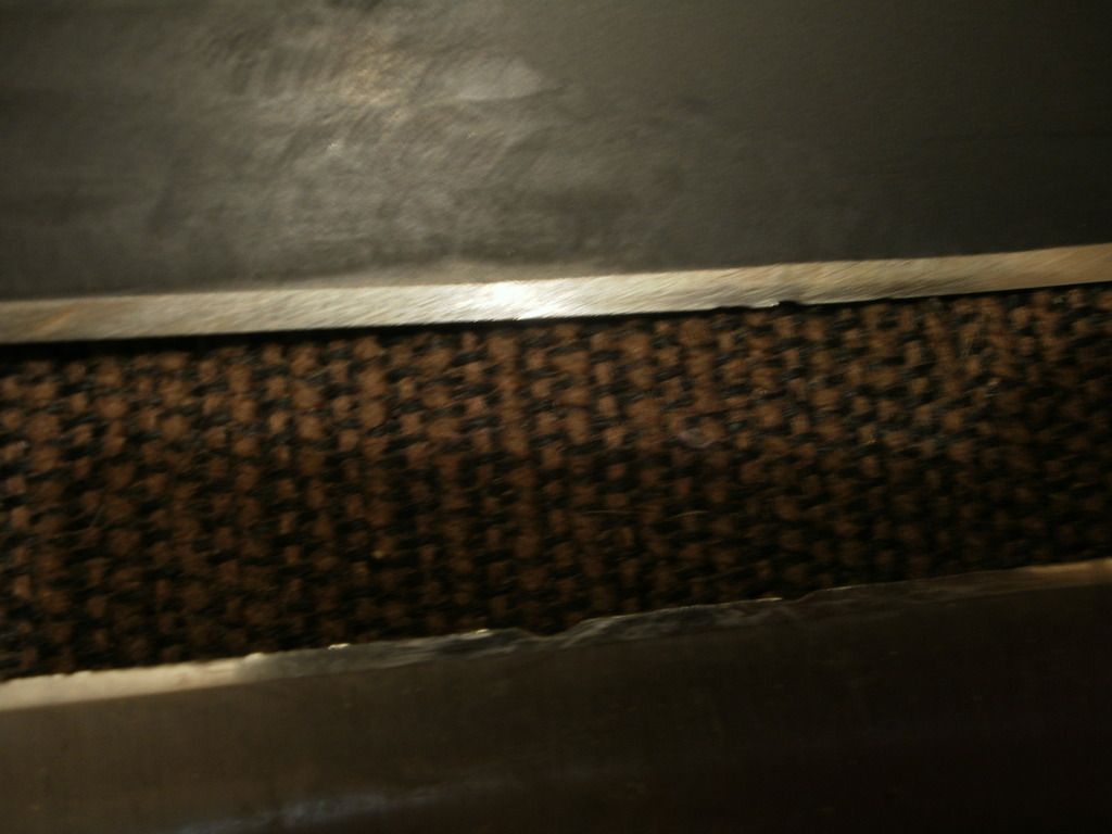

It merely requires careful attention... You involuntarily twist the knife slightly to help its removal whenever it "sticks". When you feel the "cracking" during that minuscule twist, before you start to pull it out, then you know it's the twisting that got it... Simple.
Another clue that this is what happened is also very simple to figure out: The chipping in those particular cases immediately occurs in pairs: This is because the "pinched" area of the blade naturally becomes the "center" of your involuntary "twisting", so the area in the middle of that twist has less sideways motion, but as you go outward from this center axis, in both directions, the amount of sideways motion increases, and causes apex chipping at both "outer" ends of the most tightly "pinched" area...: This is a logical explanation for the chips to consistently occur in pairs when you were not careful about avoiding the twisting motion: Here you can see the effect on one knife in 5160 and one in D-2, both occurring the same day on different steels:
Yes one pair of chips is closer together than the other, but it is the same basic principle in both cases: The difference is because the bigger knife buried itself much deeper in the same log, creating a "broader" area of severe pinching, its "shearing" edges thus being further apart... This effect is accentuated by slightly rotting ground logs that are softer on the outside but with harder cores...
Both set of chips occurred simultaneously in one "unstick"...
And yes, Full Flat Grinds are more vulnerable to pull-out twist than Sabre Hollow Grinds, because a low-saber hollow grind binds more in the wood, so lateral twisting motion is less "free": Lateral motion either forces the wood apart, or, if the wood is too rigid, then lateral motion pinches the hollow grind, causing the concave curvature of the hollow grind to convert lateral motion into vertical motion, "unsticking" the apex before major lateral forces are applied to it.
It is not complicated to visualize.
A lot of apex chipping assumed to be ingress chipping is actually pull-out chipping.
Not even Cliff Stamp seemed to have considered this as a common occurrence, which goes to show even the more technical-minded among us have their blind spots...

No.
Most people don't "involuntarily" twist knives when they remove them from wood. You're purposefully trying to damage the edge by torquing it.
Also... that chipping wouldn't be so significant if you didn't put ridiculously high angles on them. You turned perfectly good knives into straight razors.
Here's a simple chart that you should use from now on.
