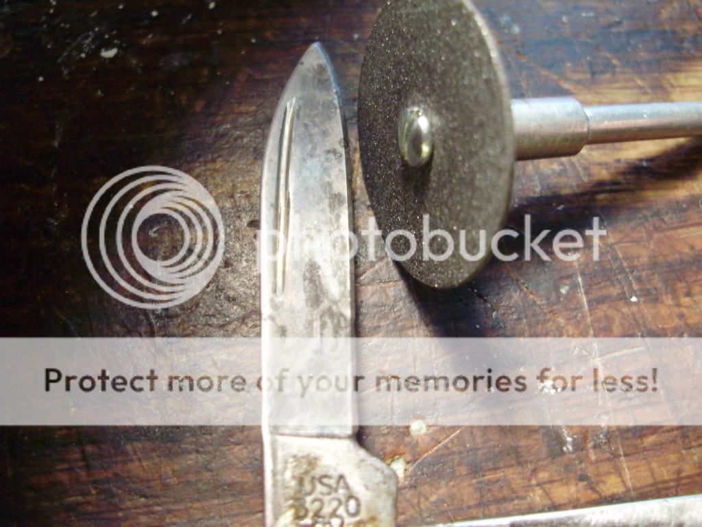

I couldn't resist giving it a try: The Easy Open Peanut.
Technically, I don't think it's an Easy Open knife unless you can pinch the blade. Being a two bladed jack, what I really did was just give the pen side an exaggerated nail relief. What really makes it easier to open is that I cut a long pull on the pen blade. This lets you lift it out from a spot farther from the pivot.
I wish I could have done a neater job cutting the pull, but it does work.
I could go a little bigger with the nail relief, but I have to be careful not to go deeper than the width of the blade or you'd be cutting off your thumbnail.I just gave it a try, and I can pinch it open if I don't mind the blade rubbing the liner from sideways pressure.
I haven't done anything to the clip side. What do y'all think?
ETA: Carl, if you're interested in trying this out, to see if it works for you, let me know.
I've resorted to pulling "down" on the pen blade instead of "up" like on the clip. So far so good!Pretty cool idea... that pen blade is a bit of stinker to get a good grip on and the pull is pretty strong on both my Peanuts.
