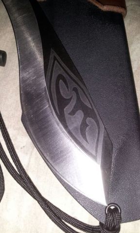

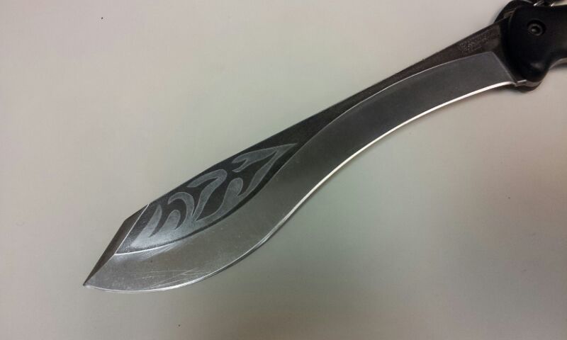

my 4, test mule for acid vs electric etch
Hi Zulu, by removing metal that protrudes from around the template and then carefully fitting the wooden handle block prior to carving. Your etching work has limitless possibilities. Good work and keep posting.
